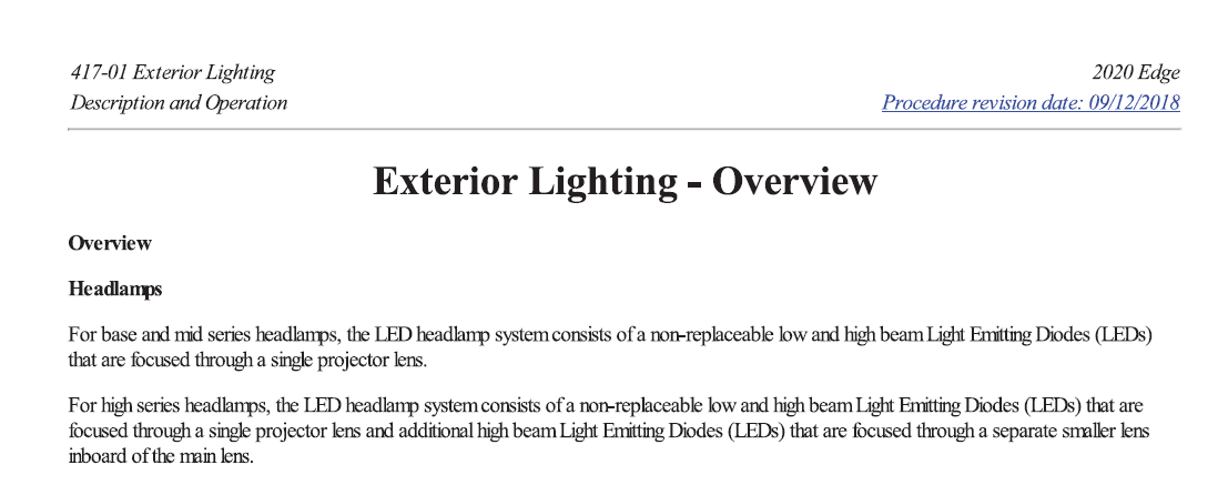

Headlamps (edited to provide high series info)
For high series headlamps, the LED headlamp system consists of a non-replaceable low and high beam Light Emitting Diodes (LEDs) that are focused through a single projector lens and additional high beam Light Emitting Diodes (LEDs) that are focused through a separate smaller lens inboard of the main lens.
