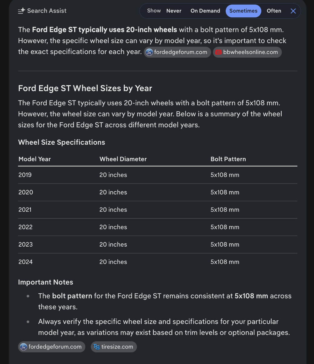

Samurai Edge Posted July 7 Report Share Posted July 7 At the time of my purchase, the standard wheel size for an ST was 20" wheels, which are 8" wide. The same goes for the Edge Sport. The optional brake upgrade included the 21" wheels. I also found this: 2 Quote Link to comment Share on other sites More sharing options...
omar302 Posted July 7 Report Share Posted July 7 If I remember correctly, all 2016-2018 Sports had 20" wheels as standard (polished & forged), with 21" wheels available as an option. 2019+ ST also had 20" wheels as standard. The 21" could be ordered as a standalone or as part of the brake upgrade package. Tire sizes were the same regardless of generation. 245/50R20 or 265/40R21. 1 Quote Link to comment Share on other sites More sharing options...
1004ron Posted July 7 Report Share Posted July 7 You guys had me go back and check my window sticker which confirms my assumptions are wrong regarding the 21" wheels being standard for the Sport and ST. Quote Link to comment Share on other sites More sharing options...
