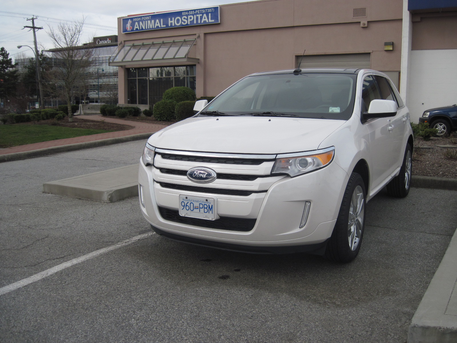

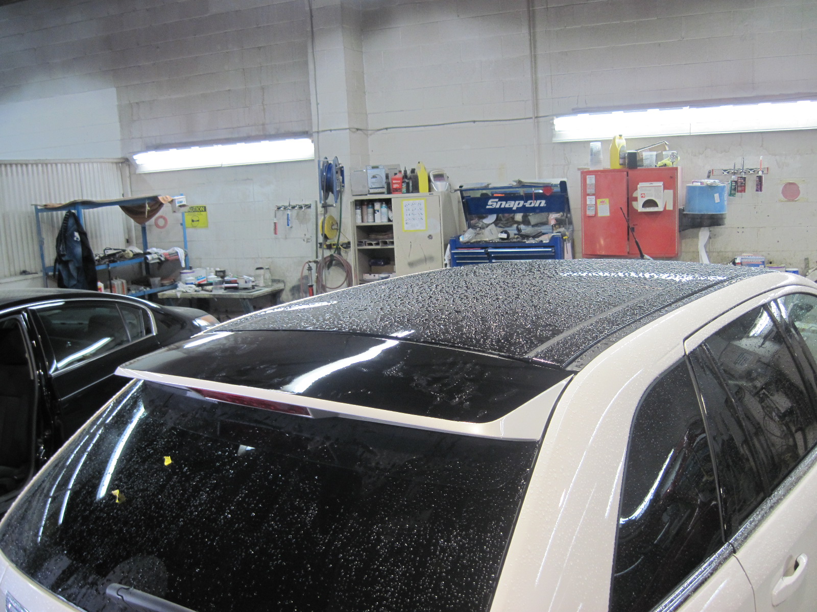

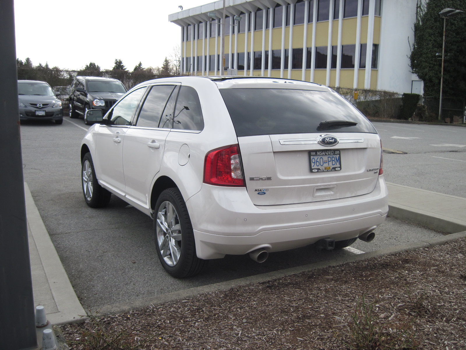

here's the final result...
The lower rocker claddings are still missing... I had to order new clips as there was no way to remove them without them breaking...
Phenomenal job on this. I was just re-reading this thread. I might've gone for the Limited if I saw something like this before buying my Sport. I had a body shop try this on a piece from my 2008, and it didnt work well. Maye if my 2008 came out perfect like yours I never would have gotten a 2011 at all? Anyway, this is something I really want to consider doing to the Explorer we just got. If the wife wants it that is.
I really like the black painted portion of the visor, good idea!
Are you planning on doing the mirror bases? It would really complete the look.
I thought about it... but I think it would be too much white.
I would think that it would compete to much with the glass - especially once I have the front windows tinted to match the back.
