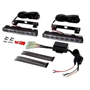

There's a bunch of different ones available, but I think a couple members posted about using this one: http://store.ijdmtoy.com/Philips-Day-Light-LED-Daytime-Running-Lights-DRL-p/led_ddl_sku_7c.htm

If you're looking to convert / retrofit them into the OEM vertical light strips in the front bumper, these would be too long to fit into the OEM housing or into the the bare opening. The maximum length of the DRL is about 7.5". If your just looking to install these in between the vertical bars of the grill, then they will be fine. I've never used these Phillips, but I have seen some good reviews on them. In case you're interested in retrofitting the OEM vertical parking light to DRLs, here's a link to my retrofit video & photos:

After some searching... I found a guy on some Porche forums state the measurements for the 8 LED are "8s dimensions: 165x18x35mm".
Ā
I also contacted an eBay seller with them, they opened the box and measured and responded 16.3 cm x 1.7 cm x 3 cm.
Ā
So it looks like about 6.5" x .7" x 1.3". Does that sound like they would fit? Yes I would be doing as you have, cutting up the existing stock light in my 2012 Limited to fit this behind the existing lens etc.
Ā
Thanks for any info,
Ā
Raymond
RayoVac, The 6.5" length is good, but what really gets me excited is the 0.7" width! At that width, I may actually be able to slide this DRL housing in between the dual light bars, positioning the DRL lens directly beneath the OEM strip lens. This in turn brings the DRL out to a point where the dual light bars would no longer restrict the beam width and allow a much wider beam spread out to the sides. I'll need to confirm the the gap dimension between the dual light bars before I can say for sure.
