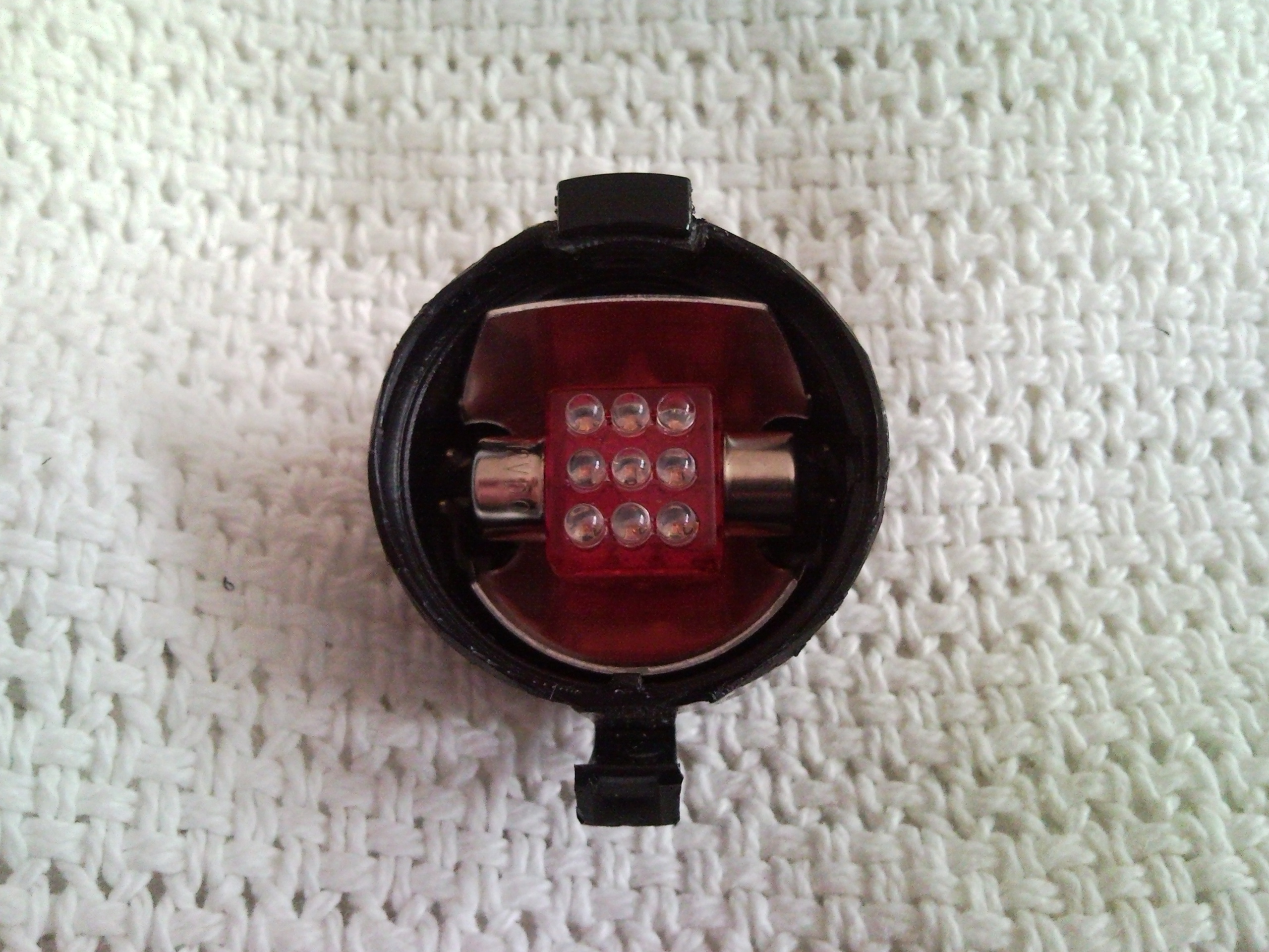

I found a way to get the puddle lamps open with little effort and no destruction. Just get a little acetone and brush along the edge where the clear and black plastic meet, it dries quick so keep applying but not so much that it drips on the top of the lens (only takes about 5 or 6 seconds). It will soften the bond the two plastics have and you can get in there with a razor blade to cut it apart. The clear part has an 1/8in lip on it that slides into the black housing so you wont be able to cut through it just enough to separate the two. Then get a sharp putty knife and wedge them apart. wasn’t able to take pictures my sis is borrowing my camera. I used these 31 mm leds that i found on ledlight.com they have 20 forward facing leds on each one. You have to remove the reflector inside the housing and sand the leds down a bit (they were closer to 34mm) then bend the led holders out a bit and set them in. When you place the clear plastic back it will hold the led in place. They are very bright compared to the stock very nice to walk up to in the dark. Took a little tweaking but was easy enough maybe about 15 min all together. Oh and i just used some karzy glue to put back together the aceton should eat that up if/when the leds fail.

Did the puddle lamps today with red LEDS. Took them apart with an exacto knife, just cut the glue line and they pulled apart with no damage. The LEDS I received from superbright were the same size (length) as the stock bulbs so they just snapped in. No bending the reflector. I checked to be sure everything was working by using a 9volt battery prior to sealing the units back together with a small amount of epoxy. Will snap them back into the mirrors when the wife gets home from work. Total time, 10 minutes, not counting the set time for the epoxy. Now all interior lamps and the puddles will be red LEDS. Should go nicely with the vehicle color.
