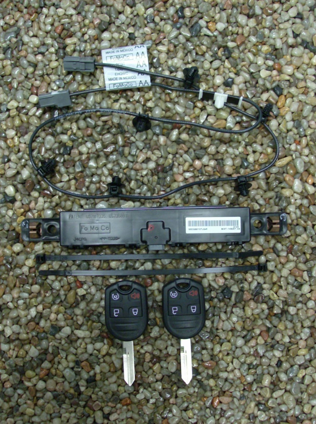

Hi, Just installed the Remote Start Kit for my ford edge Part No: BC3Z19G364A Do it myself: installation and Activation through IDS But i observe that the range of the transmitter (as shown in figure-1) is very low. Can any body suggest solution to this? Can we use some other long range keyfob for remote start from some other start kits ( may be from CL3Z-19G364- ?? Looking forward for the expert opinion. Thanks

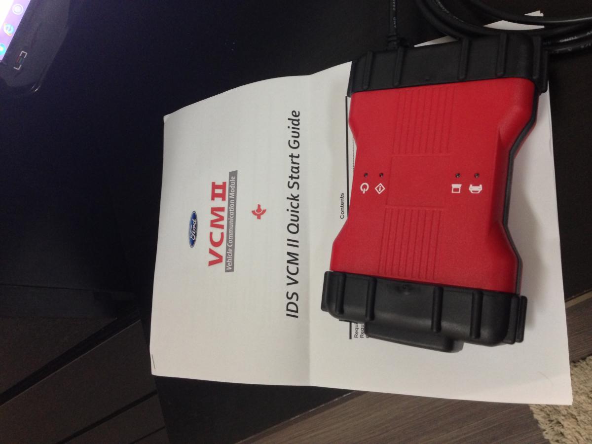

Hi Guys, Any idea about using VCM-II with the Ford Edge to activate the Remote Start option. I have recently installed the Remote Start System 100 Series Plug n Play to my edge (Myself) but Dealer is asking too much for just activating the Remote Start option through IDS. (Approx $400). I am planning to purchase VCM-II. please share your experiences Thanks

Thanks thirdgenlxi Any idea about Chinese versions of VCM-II, will it work with Edge-2013? -
