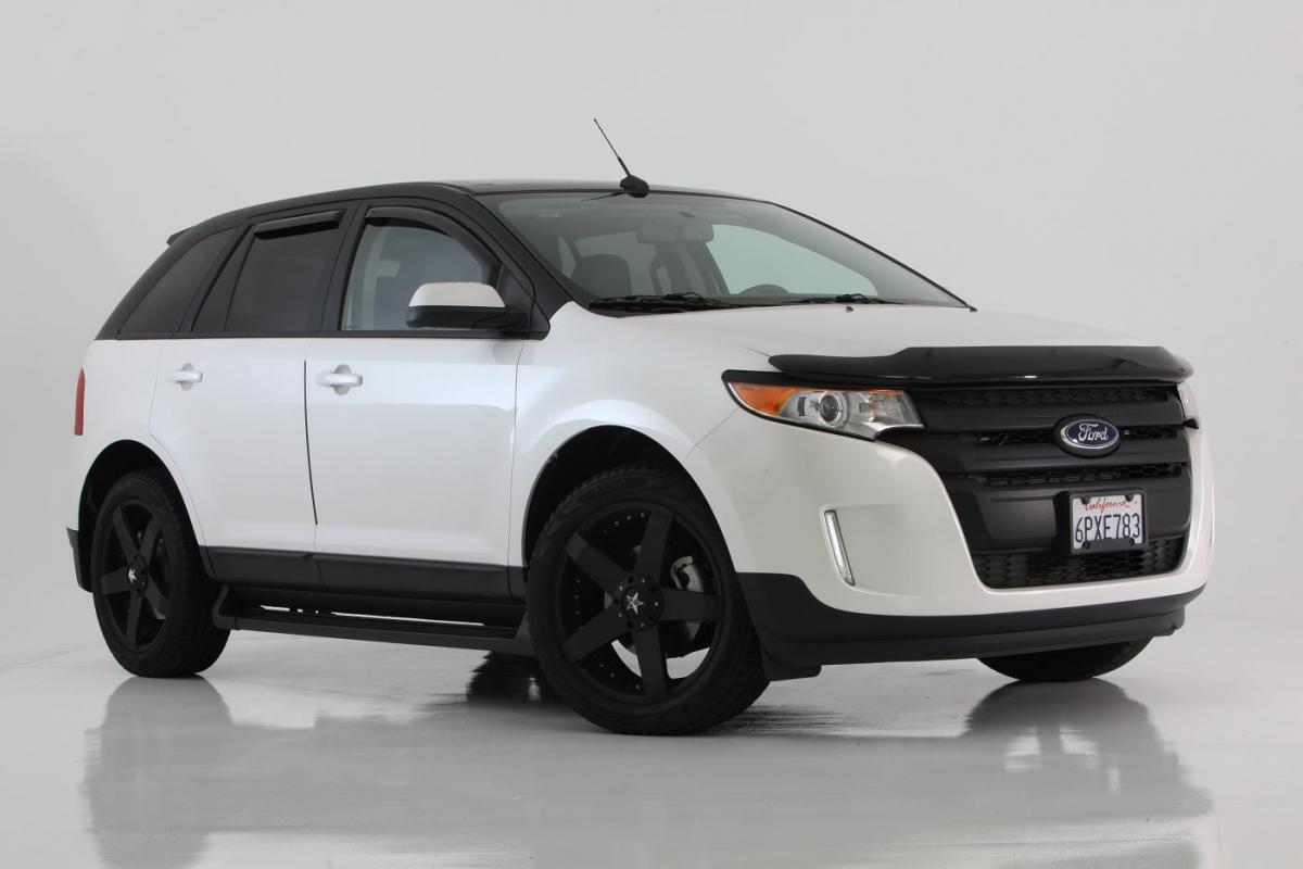

I only did the top chrome strip and above the headlights. Mine's a Sport, so it already had the black grille. If you're good with vinyl and don't have to redo a bunch of pieces, I'd guess that 3x5 would work fine, but measuring is up to you for your situation.
Thanks. I realized after I posted that it looked like you had the Sport and would have only done the top piece. Still, it looks really good. I think I'm going to try this route rather than the plasti-dip route. This one looks a little quicker and easier to fix mistakes.

The paint would indeed be softer, but not tremendously so. It's all a matter of what you want. As I said, you could just wrap the whole thing, and then your grille would essentially be wearing a condom. That being said, if it were mine, I'd have it painted. Not matching irritates me.
Okay, y'all have some patience with me. The car is still a little dirty. It didn't come out completely perfectly, but I think it's close enough that It'll work until I can move a little better from my surgery.
I loved the way the black looks on yours, so I went to a local body shop and he has a guy that will strip the chrome off and he will repaint it to match the grill.
