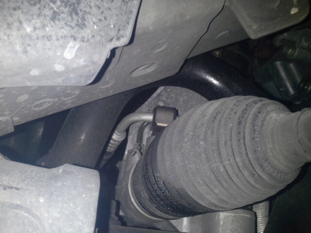

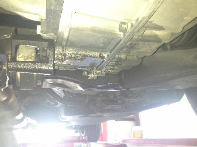

My steering rack looks pretty similar to yours. It still works with not much of an issue. The lines to your power steering have a history of breaking and it looks in your photo that the fluid is leaking and spraying the entire underside of the vehicle similar to what my power steering hose did. I am betting the power steering pump is good just a line that is leaking. Still a pricy fix as the part alone is in the $100 plus category.
