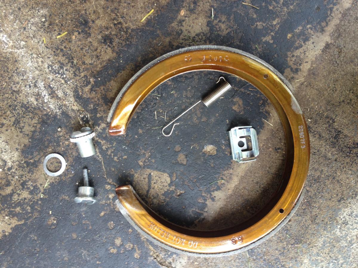

I just had the same problem. My ebrake seized on 2010 edge and it roasted my pads, rotors, and calipers. I got everything changed except the ebrake, and now I'm attempting to install the new brake shoe (with an experienced mechanic) but can't figure out where to put the coil spring. If anyone has any experience changing the brake shoes can you email me at skot_in_windsor@hotmail.com.
Thanks
