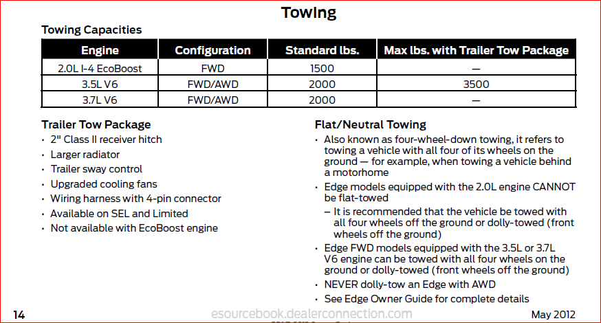

All Edges without the towing package are rated for 2000 lbs. When equipped with the Trailer Tow Package, the tow rating is 3500 lbs.
So, since the Sport does not come with the Tow Package, you are limited to 2000 lbs only. Note that it is not only the wheel size, the tow package includes several upgraded component to allow the extra weight.
See attached snapshot from the 2013 Ford Edge Source Book.
Tow ratings are a gray area, honestly. You can buy a hitch for a non-tow-package-equipped Edge that is rated for 3500#, that's what I did for my 2011 Limited. The tow package adds trailer sway control and an additional transmission cooler, but there's no physical reason that you can't safely pull a full 3500#.
