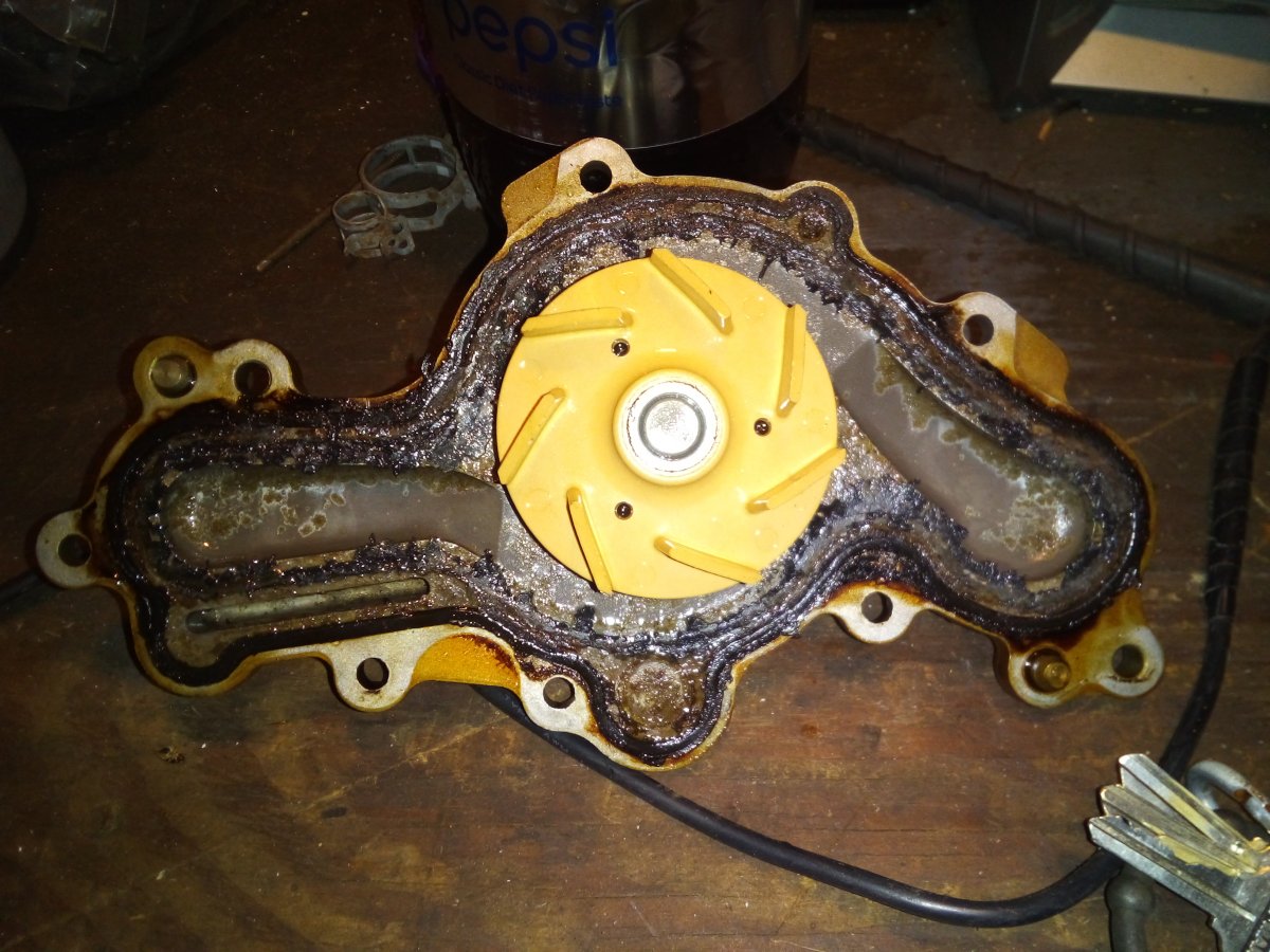

Bobbcatt Report post Posted November 24, 2020 This was my water pump. Can anyone tell me why it looks like this?? 1 Share this post Link to post Share on other sites
dajo2012 Report post Posted November 24, 2020 corrosion, corrosion, corrosion Has the coolant ever been changed? That is a mess no wonder pump failed. what year car and how many miles? 2 Share this post Link to post Share on other sites
1004ron Report post Posted November 24, 2020 1 hour ago, Bobbcatt said: This was my water pump. Can anyone tell me why it looks like this?? I agree, corrosion - obviously poorly maintained. Please add location and Model / Year to your signature - https://www.fordedgeforum.com/settings/signature/ 1 Share this post Link to post Share on other sites
Bobbcatt Report post Posted November 24, 2020 (edited) 4 hours ago, 1004ron said: I agree, corrosion - obviously poorly maintained. Please add location and Model / Year to your signature - https://www.fordedgeforum.com/settings/signature/ 2007 MKX 168,000, it was a gift because it needed a water pump. I decided to do it myself.... BIG JOB Edited November 24, 2020 by 1004ron Share this post Link to post Share on other sites
1004ron Report post Posted November 24, 2020 4 minutes ago, Bobbcatt said: 2007 MKX 168,000, it was a gift because it needed a water pump. I decided to do it myself.... BIG JOB Looks like the previous owner took care of the appearance but not the out of sight servicing - question is what else has suffered from poor servicing. Please add location and Model / Year to your signature - https://www.fordedgeforum.com/settings/signature/ 1 Share this post Link to post Share on other sites
