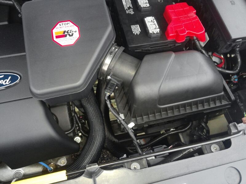

decided to do the same trick i did on the stock intake box on my 13 fx2 to my 13 edge. I took the snorcle out of the intake box and use a droo in K&N filter and boom!!! got the swusshhh sound and growl at the engine.. attached is the photo of the intake box and snorcle...

If your looking for even more intake noise/growl remove the intake muffler. The intake muffler is that square box that you have your K&N decal on. The intake muffler is attached to the rubber intake tube. You will need to cap off the holes after you remove this muffler. There was a thread on here about this mod. The caps could be bought at Homedepot, Lowe's, or Menard's.

Thanks for the info... do u have the link? if i can find a vid and pix and if they will work ok i might do it. right now im.satisfied on the sound and growl!! and i also noticed that my srock exhaust addup a mellow to it...

you talking about that square plastic piece sitting on top of the rubber intake tube? what do u recommend putting on that if i took that off? thanks!

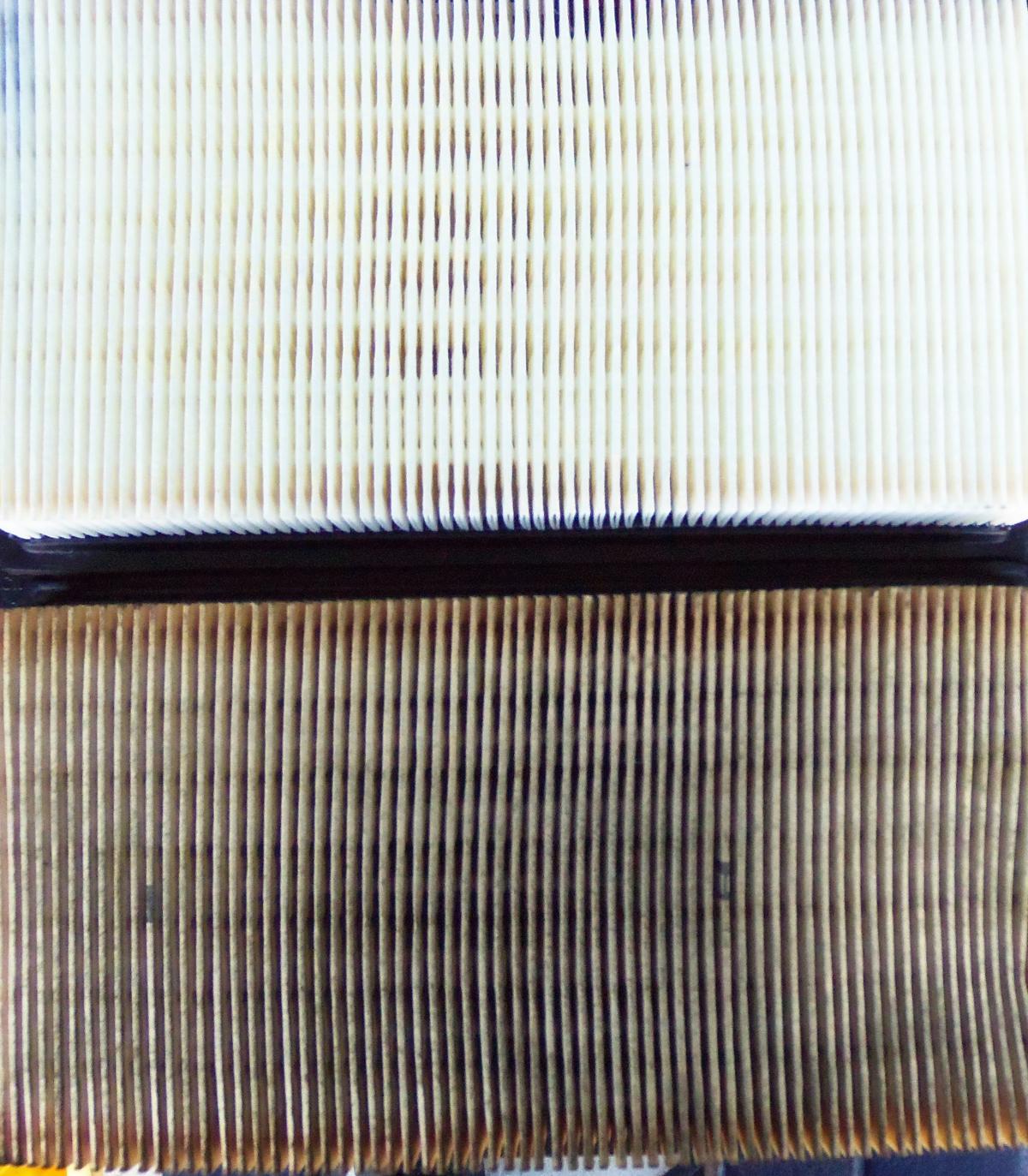

Will give it a go today. Fingers crossed :) I did change out the filter (Purolator Classic) the other day (Motorcraft, old = dirty), and I do have to say that it made a small-but-noticeable improvement. Apparently the shine-the-light-through-the-filter standard is not enough to check for adequate airflow these days.
videos?pix? lol!!!!
Attempted to capture the live differences in filters/no filter situation. Better in person :(
Old filter didn't look that dirty to me, but compared to the new one, certainly.

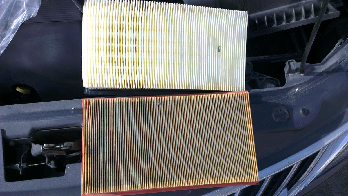

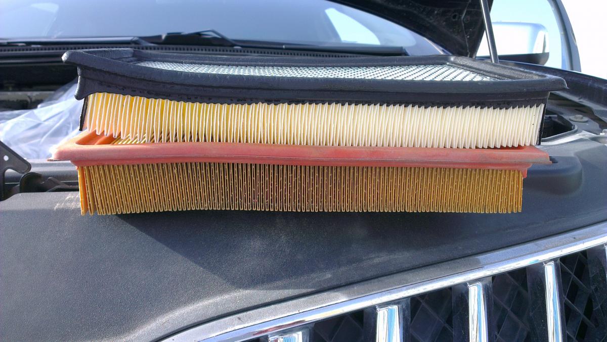

Since your talking about Air Filters, I have noticed that the replacement filters (FA-1884) is different than the one that came in the car from factory. Same part number, but the factory one was orange/yellow with a steel mesh, the replacement is black/white. Wonder what is the difference & which is better (if any is).

I would imagine them to be about the same in flow/filtration. There are a few cross-brand comparisons on the 'net, for example:
http://www.gmtruckcentral.com/articles/air-filter-study.html

I'm not sure if anyone has mentioned this, but aside from getting a different sound from the air box, this is not much of a performance mod. With the snorkel removed you are sucking in hot air from directly behind the radiator. If the sound is what you are after, use the airbox silencer delete plug from Steeda made for the 3.5 Fusion.
