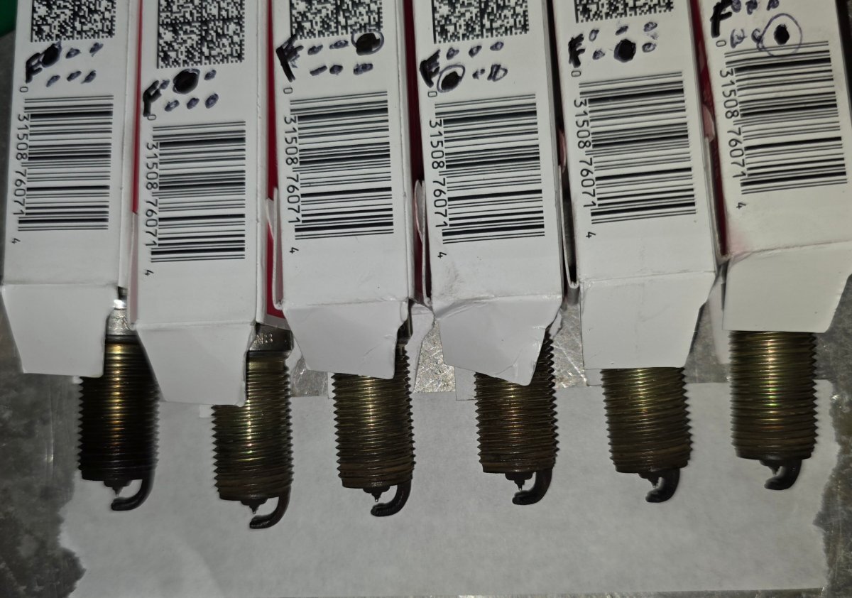

Sunnyorlando Posted October 10 Report Share Posted October 10 (edited) Having just hit the 100k mile mark on my 2017 Sport, I am working through some recommended maintenance items. First - Spark plugs - while at the dealer for separate small issue with a wheel bearing, I inquired about some of these items. The spark plugs where quoted at $549, which includes 2.5 hrs labor + the 6 plugs. I also called two other major shops and they all landed on the same number of hours, but a slightly different rate. Still spark plugs would have been close to the $500 mark. Second - transmission flush quoted at $249. Third - Brake fluid flush $225 Fourth - serpentine belt $260 Of these items I figured let's look at the ones that I may be able to do. First on the list was spark plugs. I looked up and ordered what the book called for which are the Motorcraft SP594. As recommended in nother forums I stuck with the OEM rather than messing with changing something. After looking at some videos which were not easy to find for the edge sport 2.7 l, I figured I could do this having worked on many cars and motorcycles over the years. To keep the story short, while the book calls while the book calls for an experienced ASE mechanic to do this in 2.5 hrs. I'm sure that an experienced mechanic does this in under 1 hour since it only took me just under 2hrs ( with interruptions) - while I had to study everything that had to be done and had a small issue I had to resolve with a plastic connection, I'm just a hobbyist mechanic and have never worked on this engine. If I had to do this job again, I am sure I can do it in well less than an hour and a half - imagine an experienced mechanic. I know that they have to make money, but this is a huge gap in what it takes an experienced mechanic to do and charge book hours, versus somebody who's never done it before. So basically if somebody that has some mechanical experience is willing to tackle this, it's definitely very doable in 2 hrs or less with just some slight patience. Attached is a picture of what my spark plugs look like at 103k miles. And I say 103k because I assume that they were not changed since I didn't see anything specific in the car maintenance background to indicate they were done any earlier. I've owned the vehicle since 60k miles. I'll be taking the vehicle in somewhere (not the stealer) to have the two flush services done because that's definitely something I don't want to do. I'll then tackle the serpentine belt. Edited October 10 by Sunnyorlando updated w/better pic 3 Quote Link to comment Share on other sites More sharing options...
dabangsta Posted October 10 Report Share Posted October 10 While the tips are in shadows, they look to be burning correctly, the tips worn round, and the end of the ground strap eroded, so certainly time to get it done. I did mine earlier just to get it done during a good time to work, between long drives, weather cooperating, etc. I did mine at 82k, a little erosion on the ground strap, but the precious metal tip was still square, could have gone much much longer, but for how cheap it was to do, if I pull them I replace them. 4 Quote Link to comment Share on other sites More sharing options...
Sunnyorlando Posted October 10 Report Share Posted October 10 1 hour ago, dabangsta said: While the tips are in shadows, they look to be burning correctly, the tips worn round, and the end of the ground strap eroded, so certainly time to get it done. I did mine earlier just to get it done during a good time to work, between long drives, weather cooperating, etc. I did mine at 82k, a little erosion on the ground strap, but the precious metal tip was still square, could have gone much much longer, but for how cheap it was to do, if I pull them I replace them. Thanks for the feedback. I updated the pics with a bit better one where the tips can be seen better. 1 Quote Link to comment Share on other sites More sharing options...

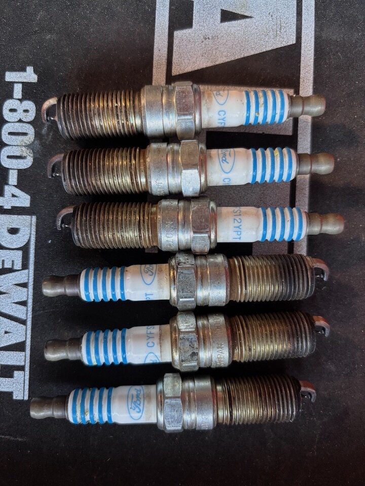

Oldandintheway Posted October 10 Report Share Posted October 10 (edited) Well done! I just bought a 2020 Edge ST with 77k and one of the first things did was an Unleashed tune and 1-step colder Ruthenium plugs. I was a car/motorcycle mechanic in the Stone Age so it wasn’t terrible, but the rear three kinda sucked haha. One of the threaded inserts on the rear coils came out with the bolt. A bit of JB Weld hopefully keeps it in place for now. I need to do all the fluids next. Still doing my research. Edited October 10 by Oldandintheway Add photo 1 Quote Link to comment Share on other sites More sharing options...
