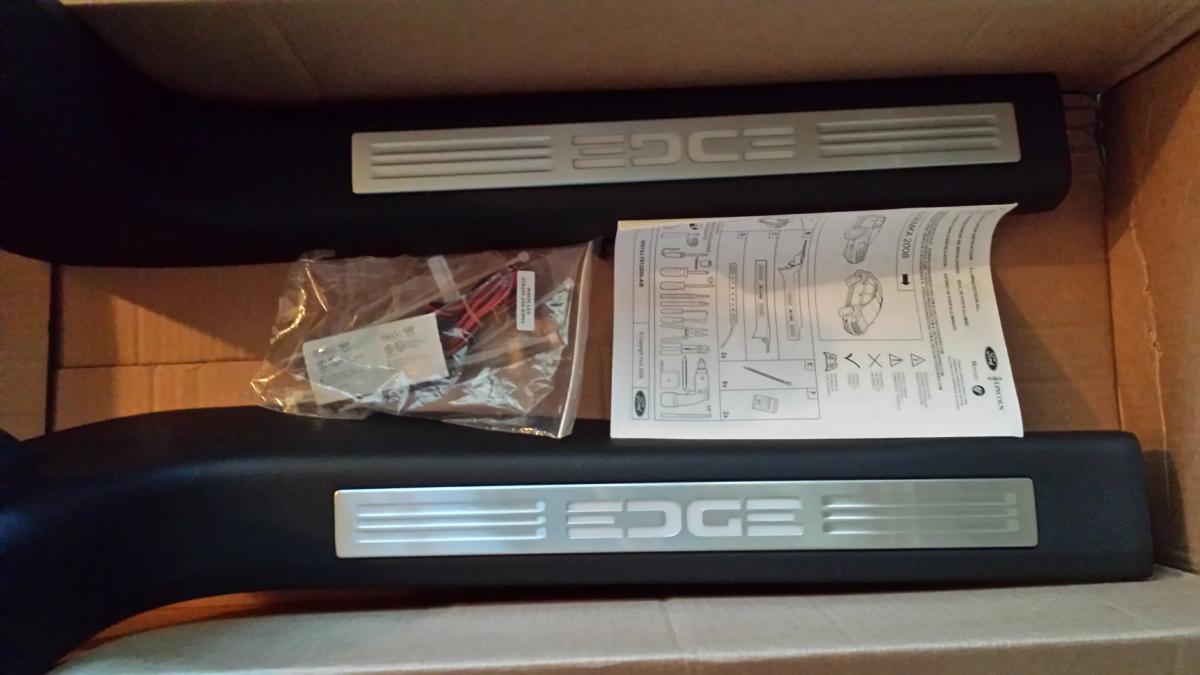

has anyone bought this part from amazon? it is the Ford part number but way cheaper?
http://www.amazon.com/gp/product/B00HB9K4JA/ref=oh_aui_detailpage_o00_s00?ie=UTF8&psc=1
I just ordered one will be here on Thursday. anyone have any tips for installing this illuminated door sill kit?
hopefully it is the actual ford part.
Ron
Thank you for posting this information. I just checked and saw there were only two of them left. I ordered one for the $36.00 after seeing they are the genuine Ford OEM parts, and that there are in fact a pair for that price. Even though they are the black color instead of the grey color I need, I may be able to do something about the color. I also noted they are for the 2011 and up models.
After ordering, I went back to the site and see they are down to one pair left, but the price is now over $116.00! I don't know if the $36.00 price was a complete mistake, some type of special deal, or what.
I have the Prime membership so should get them within 2 days. I'll post back when (or if) they come!
CinnamonEdge, I was wondering if perhaps I would be able to remove the illuminated piece from the black ones I ordered and use it in my grey ones that came in the car. I was waiting to see once I got the black ones in hand, but you have answered the question for me. My other thought was to use Duplicolor brand spray paint which has an interior plastic paint match. I don't get deliveries until around 4 or 4:30, but am expecting mine today also. Nice to see they are what we thought they were and there was no problem getting them!
