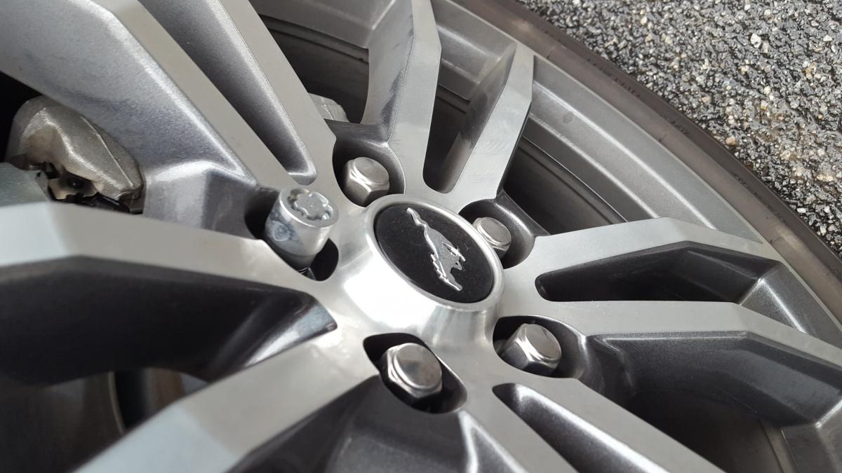

anile_eight Posted November 4, 2015 Report Share Posted November 4, 2015 I was going to order the wheel lock kit for my new 2015 Edge Sport with the optional 21" wheels but after reading and finding this in the parking lot I definitely will not. I am pretty dissapointed with ford that they don't have a better solution. My 10 year old VW had a wheel lock kit with all the same lug sized and length so it did not protrude (even had lug nut overs so you'd never know). Is there any other solution or options others have used? I don't want to come to my car one day on blocks and these pretty wheels are gone. Thoughts? Quote Link to comment Share on other sites More sharing options...
luminator Posted November 4, 2015 Report Share Posted November 4, 2015 As a former tire tech for a local tire shop, that style take 30 seconds with a hammer and a can of compressed air to remove, if the first option hammering a socket over it did not work. Quote Link to comment Share on other sites More sharing options...
anile_eight Posted November 4, 2015 Author Report Share Posted November 4, 2015 As a former tire tech for a local tire shop, that style take 30 seconds with a hammer and a can of compressed air to remove, if the first option hammering a socket over it did not work. I don't think I follow. Are you referencing the lug nut covers? Because there is a tool next to the wheel lock socket that is used to remove them and it is very easy just an "L" shaped piece of metal. Quote Link to comment Share on other sites More sharing options...
luminator Posted November 4, 2015 Report Share Posted November 4, 2015 No, if someone either loses the lock nut key or worse someone who is stealing them and will not care if they damage them. Because the nut sits so far outside the rim lip they are very easily broken off and stolen. Quote Link to comment Share on other sites More sharing options...
jacksprat Posted November 4, 2015 Report Share Posted November 4, 2015 No, if someone either loses the lock nut key or worse someone who is stealing them and will not care if they damage them. Because the nut sits so far outside the rim lip they are very easily broken off and stolen. As a guy who is about ready to order a 2016 Edge Titanium, are you suggesting it might be a waste of money to order the locking wheel nuts? That they are to easy to break off? Your expert opinion would be welcome. Thanks! Jack Quote Link to comment Share on other sites More sharing options...
anile_eight Posted November 4, 2015 Author Report Share Posted November 4, 2015 As a guy who is about ready to order a 2016 Edge Titanium, are you suggesting it might be a waste of money to order the locking wheel nuts? That they are to easy to break off? Your expert opinion would be welcome. Thanks! Jack Looking at the locking lug nuts that would take some real effort to break it off. My concern is first it is hideous and secondly is you now have an uneven weight on the wheels which could cause some vibrations. Quote Link to comment Share on other sites More sharing options...
