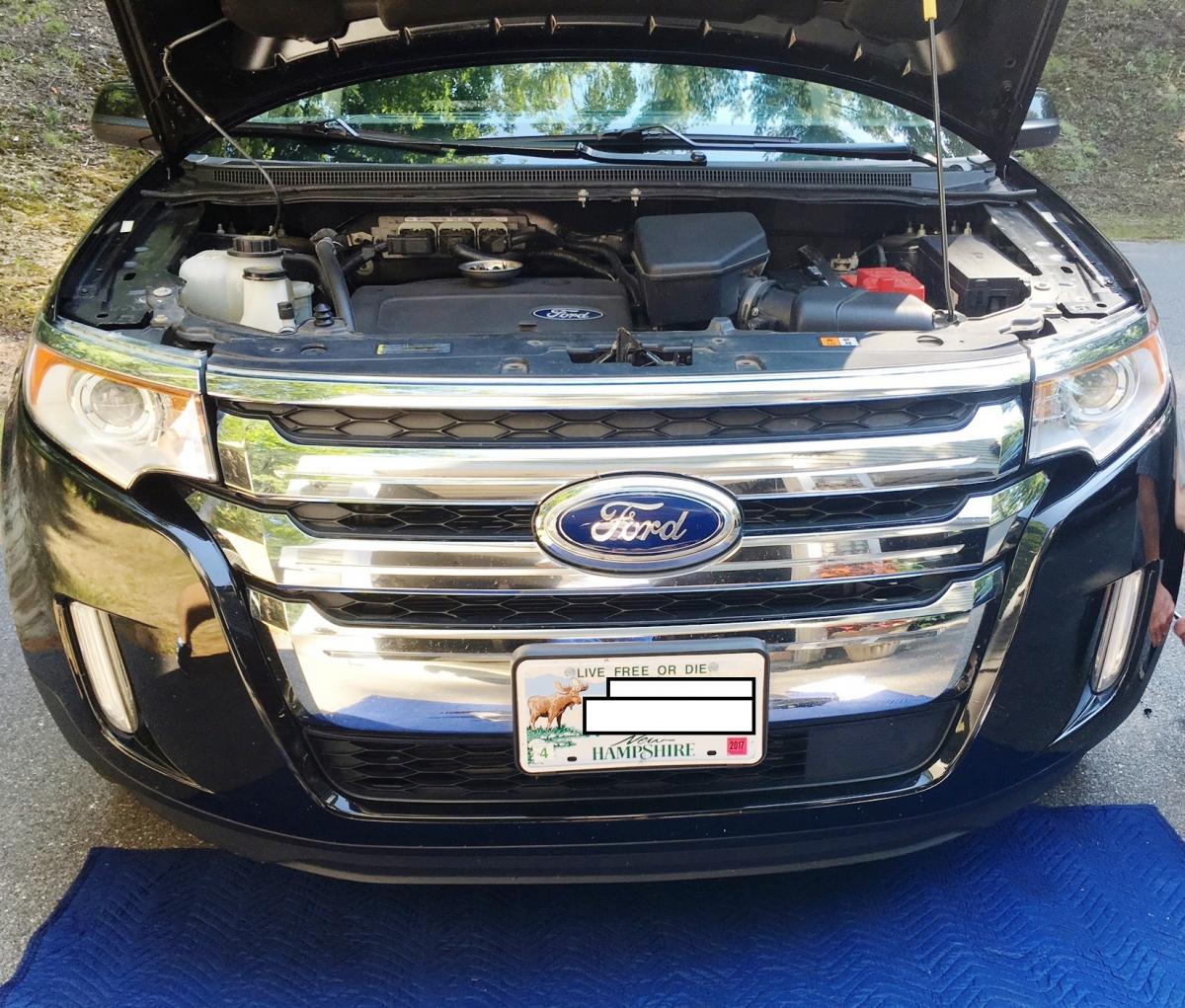

pedro2u Report post Posted September 6, 2016 I finally changed the grill on my black 2011 Limited. I've never liked that big chrome smile from the OEM, so I wanted a black alternative like the Sport. I ordered the parts from Ford ($108 delivered). They come on black plastic so I chose to install them as is without painting as others on this forum have done. Thanks for this video by enigma-2 on this forum which made bumper removal a snap: http://www.fordedgeforum.com/topic/20745-2011-2014-lower-chrome-grille-replacement/?do=findComment&comment=154262 The only changes to the enigma-2 video I came across were with the bolts under the bumper. Video showed 9 10mm. I only had 4 (2 10mm bolts on each end) and 3 plastic pop-pins in the middle. Quick work. To pull the bumper, having an extra pair of hands made this a quick job. In my state you must have a from front license plate, and it took a bit longer to cut off the 2 plate holder rivets from the back, center it on the black replacement, drill the holes, and secure. But easy enough. So here's the before and after pics. If I ever decide to have them painted and clear coated, I know it's an easy task to disassemble. But I'm fine with this result. I'll monitor how it stands up 1 Share this post Link to post Share on other sites
WWWPerfA_ZN0W Report post Posted September 6, 2016 Does make a difference! Thanks for the addn'l info on the install Share this post Link to post Share on other sites
Burrcold Report post Posted September 6, 2016 That looks really good! Share this post Link to post Share on other sites
