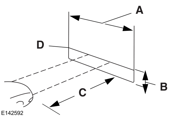

Headlamp Aiming Target
A 8 feet (2.4 meters).
B Center height of lamp to ground.
C 25 feet (7.6 meters).
D Horizontal reference line.
Vertical Aim Adjustment Procedure
Park the vehicle directly in front of a wall or screen on a level surface, approximately 25 feet (7.6 meters) away.
Measure the height of the headlamp bulb center from the ground and mark an 8 foot (2.4 meter) horizontal reference line on the vertical wall or screen at this height.

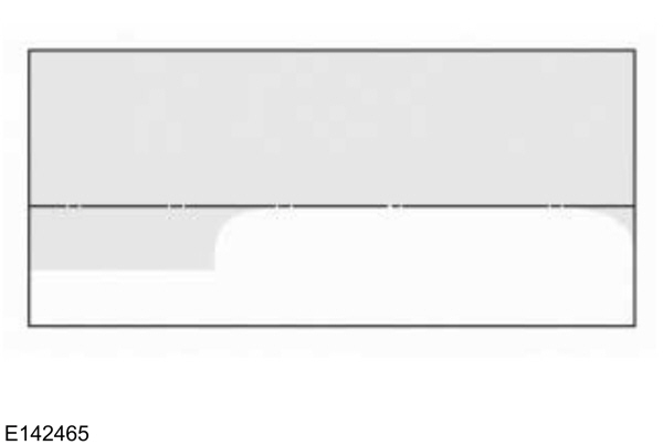

Turn on the low beam headlamps to illuminate the wall or screen and open the hood.
On the wall or screen you will observe a flat zone of high intensity light located at the top of the right hand portion of the beam pattern. If the top edge of the high intensity light zone is not at the horizontal reference line, the headlamp will need to be adjusted.

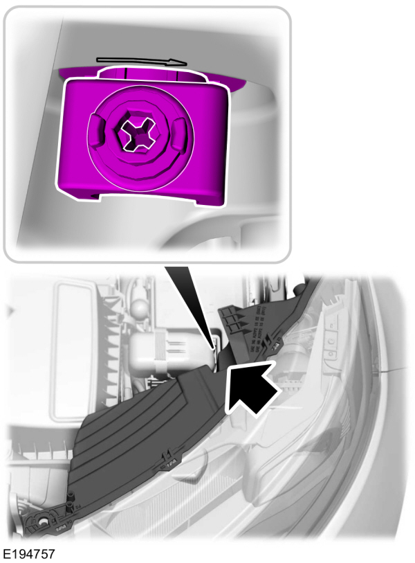

Locate the vertical adjuster on each headlamp. Using a Phillips #2 screwdriver, turn the adjuster either clockwise or counterclockwise in order to adjust the vertical aim of the headlamp. The horizontal edge of the brighter light should touch the horizontal reference line.
