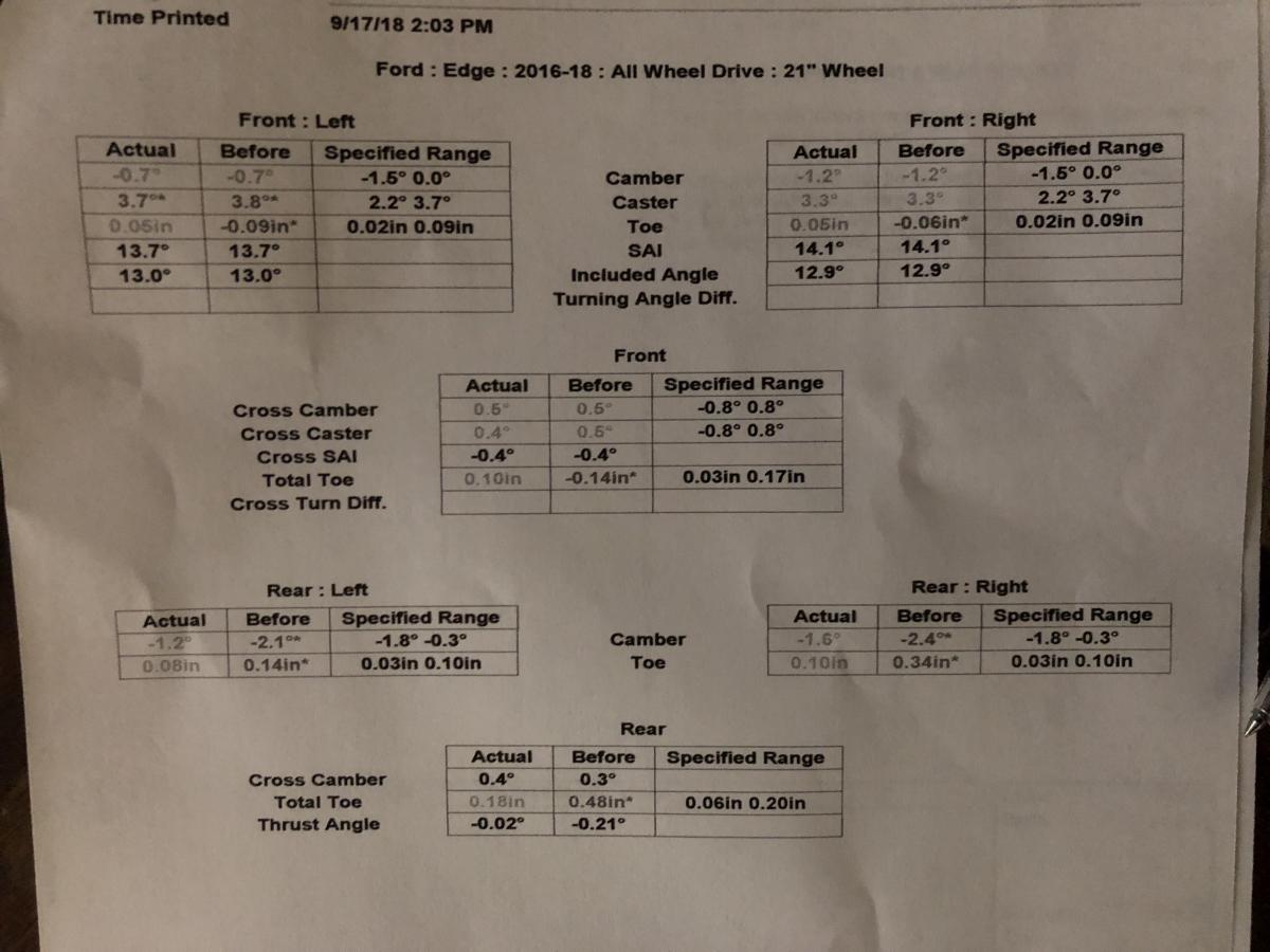

Hi all,
Finally took the Edge in for alignment...about a month later after my self install of the springs. Front was not too bad, rear was out.
Edited by NoDTMF
Hi all,
front was pretty good for sure! the rear camber tho ...
Yeah...well remember I dropped the complete subframe, that probably had something to do with it. But I haven't heard of anyone lucky enough to get it in-spec using either replacement method.
