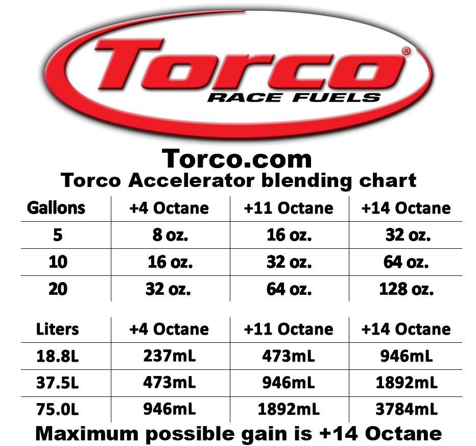

This is one of the best octane boosters that you can get. Mixing instructions are on the can.

 Very interesting I was not aware of this , Race Gas looks to be a very good quality product. It appears to be similar to Torco in that it is not just an octane boost per say but an additive to gas that converts it into race fuel. They are both safe for oxygen sensors and catalytic converters.
The  big difference I can see right away is in the price. On Amazon Race Gas costs $31.55 per Qt. and Torco costs $19.90 per Qt.
With Race Gas to make 91 octane 101 you need to add 5 oz  per gal. So  one quart will raise 6 gal of 91 to 101. That works out to $5.26 per gal + the cost of the 91 gas.
With Torco  one quart will raise 10 gal of 91 octane to 102. That works out to $1.99 per gal + the cost of the 91 gas.
One big thing to remember is that the all time 1/4 mile record for the Ford Edge was set with Race Gas in the tank and that says a lot.
In conclusion 037 and I have presented solid choices for converting pump gas into race fuel. Not just octane boosters.

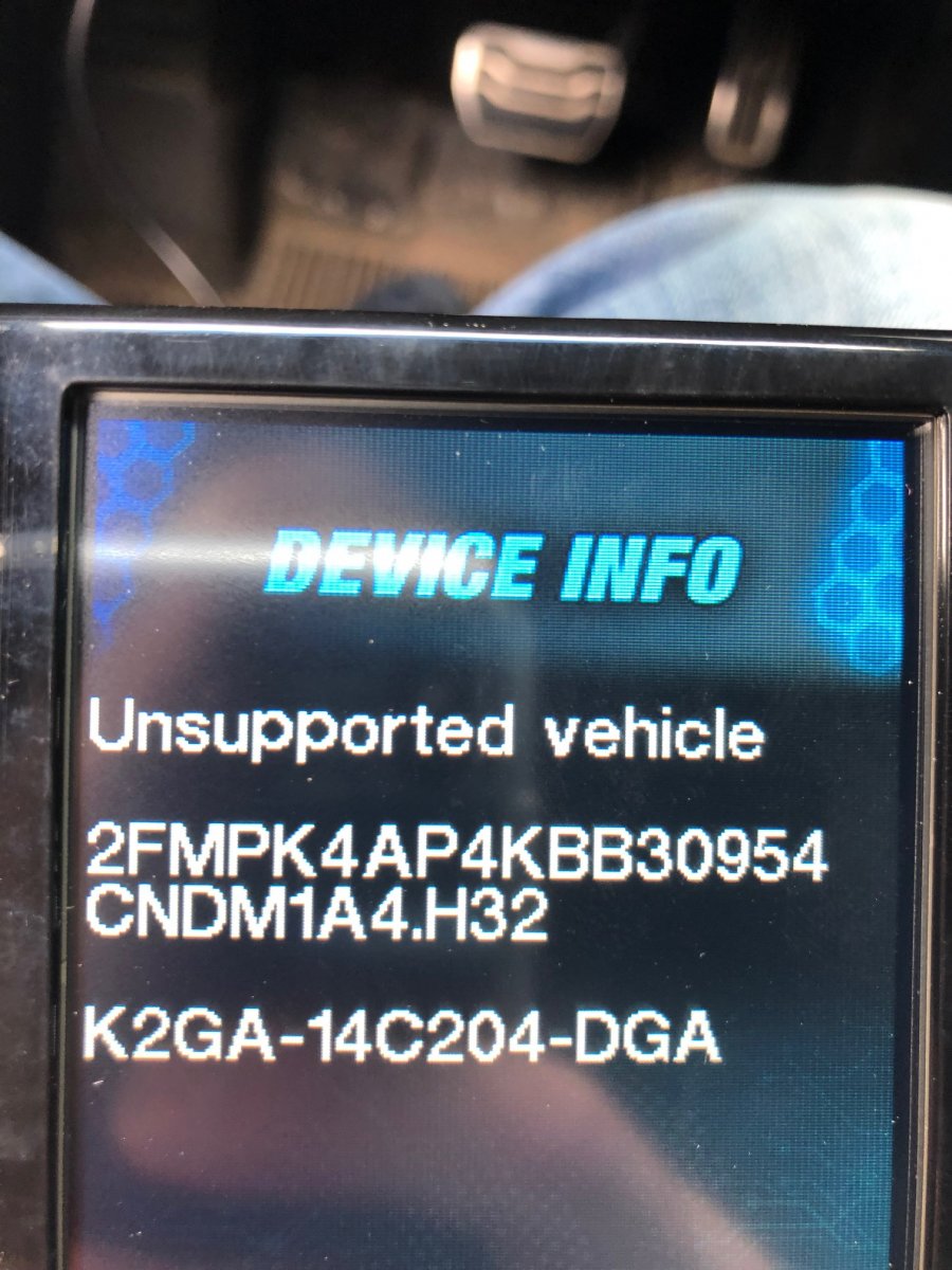

Am I the only one who struggled filling out the tune form for the livernois mycalibrator touch? I feel like the code description they need didn't match the code description my car showed.
For example:
They ask for ECU/SC, all I could find was CCPU/SW.
Same thing?
If not, where the heck do I find it?
Also, instructions say download your stock tune to the mycalibrator and upload it to the tuner program on your computer (installed that program yesterday). But when I plugged the tuner into my car for this, the touch screen came on but nothing happened. I couldn't tell of it was doing anything and it didn't have options to pick. Just the on screen and nothing else. I waited a few minutes and nothing. Kinda don't know what to do now.
For example:
Same thing?
That i what I got on mine.  Top number is VIN then the ECU/Strategy Code then the SW ID number.  You send them the info and I attached the picture and then they should send you an email when it is done.  You will then plug your unit into the computer and run the MyCalibrator software and it will download the tunes they give you, for me they just sent 87-98 Perf, 91 Perf, and 93 Pref tunes because on the fuel question I put 91 and 93, or maybe they just send those to everyone.  Then the next time I plugged the unit into the car it saved the stock tune then I turned the car off and unplugged the unit and waited about 10 seconds and put the car back into Run mode, not started, and plugged the unit in and selected my tune.  It did its thing and I then turned it off and back on and drove it.  I did have to reset my Sync 3 unit because the screen came on and the radio then eventually went blank but the music still played.  It was fine after the reset, hold power and Search Up buttons until it resets.  I did not hear anything from them within 24 hours so I sent a Message to them and they had forgot to let me know the tunes were ready for the unit.  So if you do not hear anything within the 24-48 hour window then call or message them from the site.

11 hours ago, TRYING2ADULT said:
For example:
Same thing?
Under vehicle info I got a "CODE" & "SW" and sent them to Livernois.
For the stock tune, after connecting the tuner to the PC, did you run the MyCalibrator software (app) on the PC? After running it (opening it) it should connect automatically to the tuner and send the stock tune. The App's information will show you a dialogue of what's going on, if I recall correctly.
