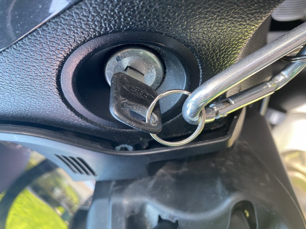

Ok I am new here and I have an explorer that I am trying to do this mod too, but the cluster doesn’t fit back and allow any bolts to line up and secure. Even the trim doesn’t fit flush but it sticking out. I think the heat sink is the issue. 2017 Explorer FPIU.
Edited by FL_Not_A_Cop
For the Explorer a plastic brace has to be cut out and the PLATINUM cluster lens and PLATINUM cluster bezel has to be used.
