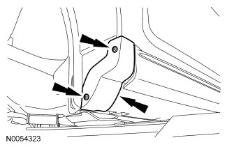

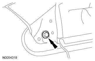

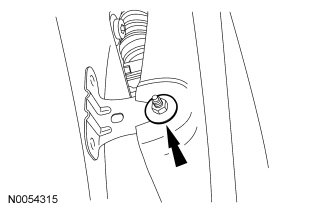

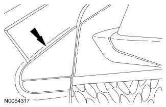

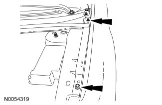

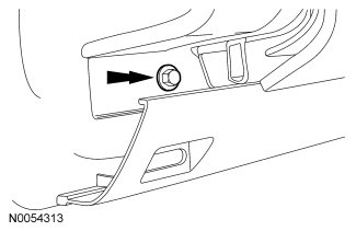

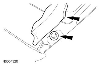

enigma-2 Posted August 24, 2020 Report Share Posted August 24, 2020 (edited) Is this what you're looking for? (If you run your curser over the images, you can read the titles, i.e. no 1.jpg, no 2.jpg, etc.) Fender Removal and Installation 1.Remove the 2 screws and the rocker panel moulding end cap. {image 1} 2. Remove the front fender splash shield. For additional information, refer to Fender Splash Shield in this section. 3. Remove the lower fender bolt. To install, tighten to 9 Nm (80 lb-in). {image 3} 4. Remove the nut from the stud inside the fender well. To install, tighten to 9 Nm (80 lb-in). {image 4} 5. NOTICE: The front bumper cover may be damaged if pulled outward too far while trying to access the bolts. Remove the front fender bolts. Remove the front bumper cover corner. Remove the bolts. To install, tighten to 9 Nm (80 lb-in). {image 5} 6. Remove the upper rear fender bolt cover. {image 6} 7. Remove the upper rear fender bolt. To install, tighten to 9 Nm (80 lb-in). {image 7} 8. Remove the 2 upper fender bolts. To install, tighten to 9 Nm (80 lb-in). {image 8} 9. Remove the fender cowl bolt. Position the cowl cover aside. Remove the bolt. To install, tighten to 9 Nm (80 lb-in). {image 9} 10. Remove the front fender. 11. To install, reverse the removal procedure. If necessary, transfer parts. Edited August 24, 2020 by enigma-2 Add note on image title 1 2 Quote Link to comment Share on other sites More sharing options...
