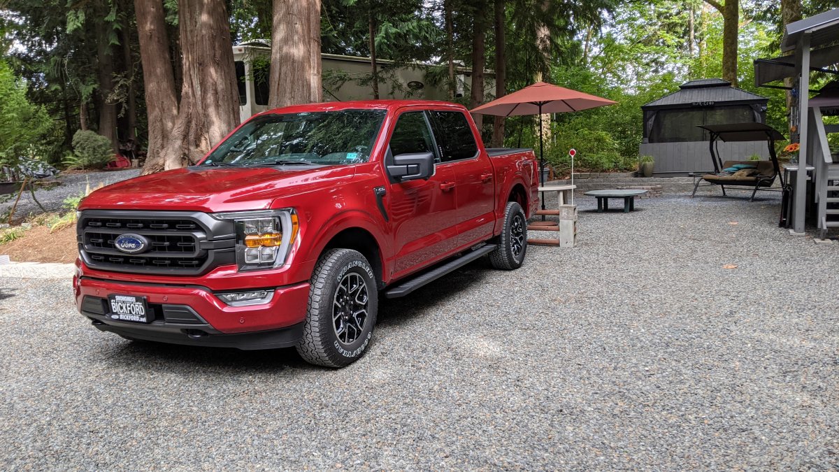

Snoking Posted September 4, 2021 Report Share Posted September 4, 2021 (edited) Well I resolved the towing issues today. Dealer gave me more than we paid for the ST 15 months ago and 2K off MRSP on this F150. I guy really needs a pickup truck! It has the 12" sync 4 screen, co-pilot 360, 10speed with the 2.7L 325/400 and many other things the Edge did not have including more conformable seats. Quieter and smoother on the road. Edited September 4, 2021 by Snoking 3 Quote Link to comment Share on other sites More sharing options...
