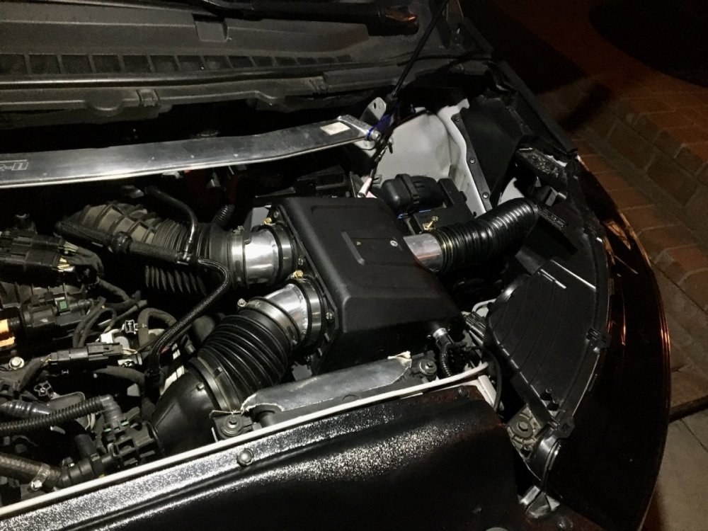

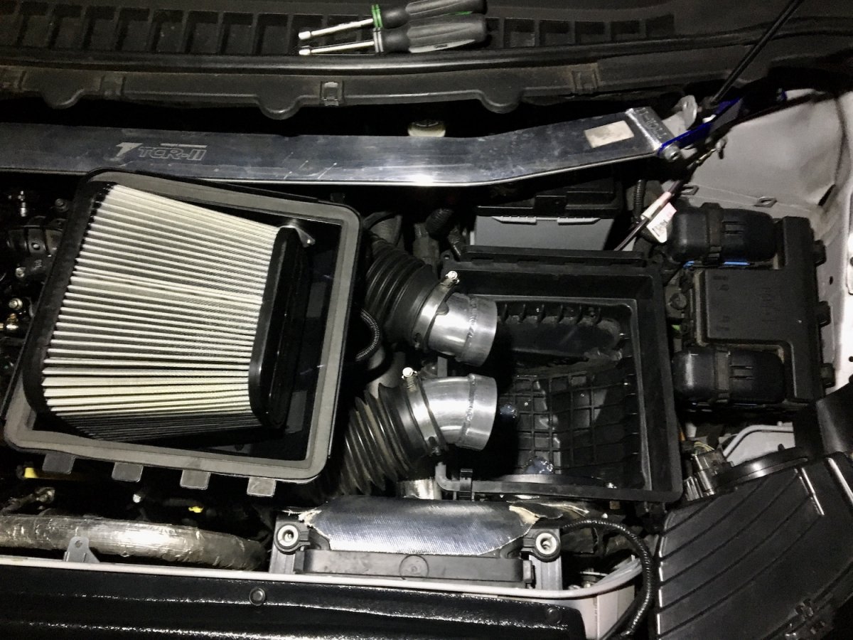

As I said I was on a roll. Decided to remove the V3 and check everything out . The insulation does not have a strong glue on the back and it was coming loose in a couple spots. Otherwise everything checked out fine.
I found out some install tricks and also found out you can check the filter with removing the entire unit.
As long as I had the top off I decided to try out the other top with the aux air intake on it.  Then did a Saturday night test drive,

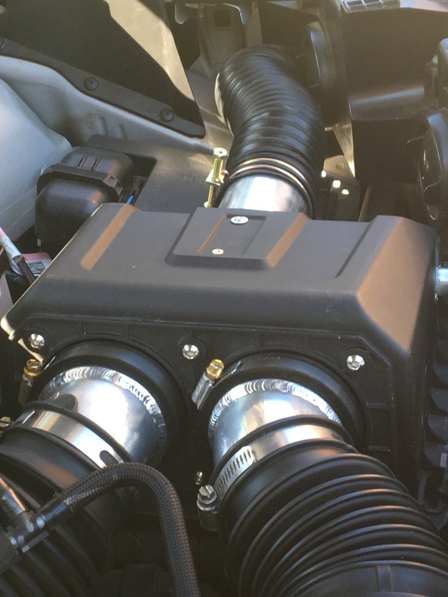

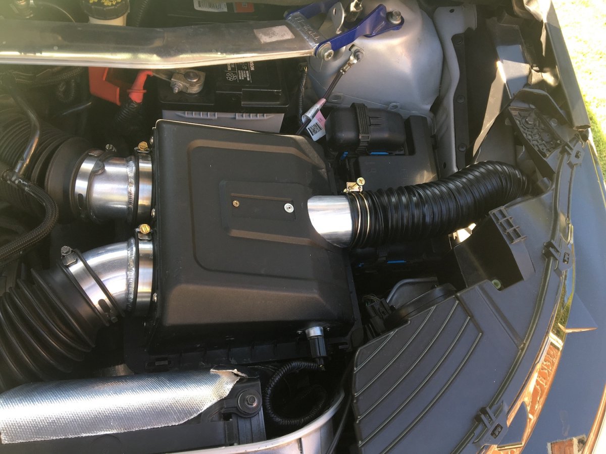

JUst thought i should post a daytime photo

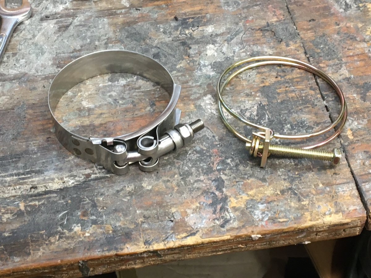

I tried an expensive SS clamp on the flex hose, but the simple double wire clamp worked best.
The car likes the added air but it feels like it could use a tune to get the most from it.

These are the clamps I tested on the Aux Air intake hose. As the hose is corrugated, it turns out that the double wire clamp is best. The double wire clamp applies pressure where the hose touches the tube, and holds tight. The larger SS T-Bolt hose clamp applied pressure at the top where the wire is in the hose, and that allowed the hose to slip off.
I have had heated debates about T bolts and their use. I personally prefer the worm clamp style but not your normal ones. I have used these for quite awhile with great success.
https://www.flatironstuning.com/turbosmart-murray-constant-tension-clamps

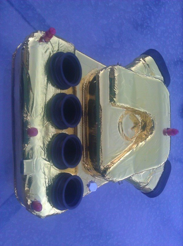

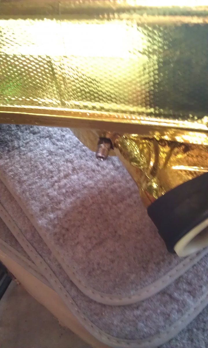

@Xtra I have used DEI Reflect-A-Gold on my Hayabusa airbox. It has the same type of sticky backing and works probably as good or maybe better than you experienced. I really cleaned the plastic well with Isopropyl alcohol. Still not perfect but unless you want to put on a more permanent glue, it works well enough. It worked reflectiing heat as per my not quite scientific findings.
I will be trying a new reflective tape that is supposed to be better but I have my doubts. I got it for the stock airbox originally but will try it on the new box.
EDIT: Found some pics
TY Steve, thanks for sharing your experience with this insulation. It looks good with the golden finish, like something from NASA,  and appears to be more flexible and stick better than the Thermo.Tec. I will look into it.
Thermo-Tec is good for reflection of over 90 percent of the heat to  2,000*  and can take up to 300* in direct contact . The specs are great, The glue not so much.
