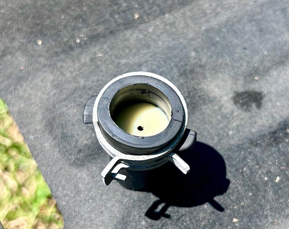

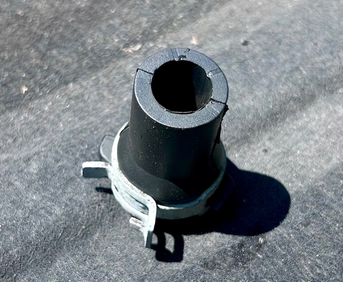

chipdog4 Posted December 9, 2024 Report Share Posted December 9, 2024 (edited) I just drained and filled my transmission. I had a valve body replacement (and fluid replacement) just before 60,000 miles under warranty (due to the surging) and I have 82,750 currently. I got 4.5 quarts out and put that much back in. It was very dark fluid and smelled like gear oil. I think I'll be changing it every 20,000 miles from here on. Just wanted to add something as I was getting confused by the funnel talk. The cap that needs to be removed is just a breather hose/vent. There's actually a cable type clamp that would work great to remove the clamp (linked below). After finally seeing it, I'm going to get a length of fuel line and extend it up near the top of the engine so I won't have to remove the air box and zip tube next time for a transmission drain and fill. Should have measured it but maybe 3/4" hose by 2 feet and zip tie that off somewhere and put that little breather cap on top of that. Not sure why it rotates my pictures. Edit: my fluid level plug on the side was super tight. It takes a 10mm hex bit socket. I was using 3/8" drive and was flexing the ratchet. Stepped up to 1/2" drive and got it loose. I was able to check with the tire on and turned all the way to the right and laying on my back. Need about 10-12" of extension with the socket. https://www.homedepot.com/p/GEARWRENCH-Cable-Hose-Clamp-Pliers-82115/303732784 Edited December 9, 2024 by chipdog4 3 Quote Link to comment Share on other sites More sharing options...
fishx65 Posted May 20 Report Share Posted May 20 Just did a drain and refill on my 30,000 mile 22 ST-Line 2.0. That little breather hose wasn't too bad but make sure to face the clamp tabs forward when ya put it back on to make it easier next time. I was lazy and just put back in what I drained out which was about 5 1/4 quarts. 2 Quote Link to comment Share on other sites More sharing options...
