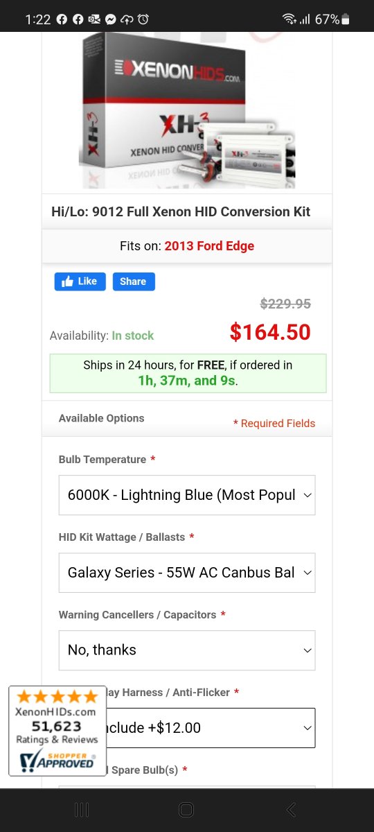

griffithroberth Posted January 24, 2022 Report Share Posted January 24, 2022 I was considering upgrading my stock halogen headlights to a HID system. I was looking at this system from https://www.xenonhids.com/dual-beam-hi-lo-9012-full-xenon-hid-conversion-kit.html?i=y3ezje If you could please advise if this is a good system to use to upgrade with. Also, I recently bought two new key fobs. I only have one key fob that was paired to the car. I put the vehicle in pairing mode and got the keys to lock/unlock the vehicle, remote start and panic all work great. However, the keys will not start the vehicle. When I try to use the key,the acc mode comes on just fine and then when turned over to start it says starting system failure. Did I do something wrong during pairing? I do not have the push to start nor do I have a power lift. The key and fob are all one unit. Thank you for the help. Quote Link to comment Share on other sites More sharing options...

fishx65 Posted February 6, 2022 Report Share Posted February 6, 2022 That HID kit should be fine. They're all pretty much just cheap Chinese kits at that price range. I finally had a bulb go out in my 2011 yesterday which has been sporting a $45.00 35/5000 DDM kit for almost 10 years. 3 Quote Link to comment Share on other sites More sharing options...
