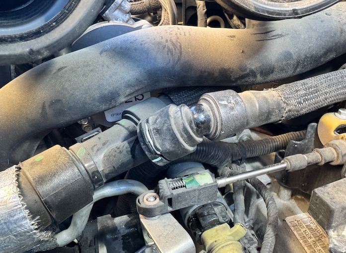

clay0708 Posted January 23, 2025 Report Share Posted January 23, 2025 Hi all, I just located a coolant leak on my 2016 Edge Sport, 2.7L EcoBoost. Appears to be dripping from a radiator hose quick connect located just beneath the air intake. It's a "Y" connection, and when agitated, it drips coolant quite a lot. Can anyone tell me what part this is specifically, and what it would look like to replace it? Could I just replace the Y connection since the hoses are all fine? Thanks for the help! 1 Quote Link to comment Share on other sites More sharing options...
omar302 Posted January 23, 2025 Report Share Posted January 23, 2025 If I'm not mistaken in my Edge the leak was from the Plastic piece circled below. It was like the outer piece enlarged and would not seal properly. Unfortunately it is part of the full heater hose. This part. Though you have to make sure this is the correct part number for your Edge. Mine is a GCC model with extra cooling so the hose is different. The part I linked above should be the for the standard North America model. 2 Quote Link to comment Share on other sites More sharing options...

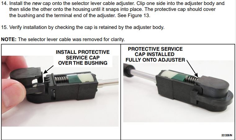

omar302 Posted January 23, 2025 Report Share Posted January 23, 2025 46 minutes ago, clay0708 said: @omar302 Whats the deal on the linkage bush? As stated and linked to by @1004ron above. There was a recall to replace a small plastic bushing that could fail and then the shift lever would disconnect from the transmission. The connecter circled below in your photo clearly shows that it was NOT done, or not done fully/properly. 1 1 Quote Link to comment Share on other sites More sharing options...

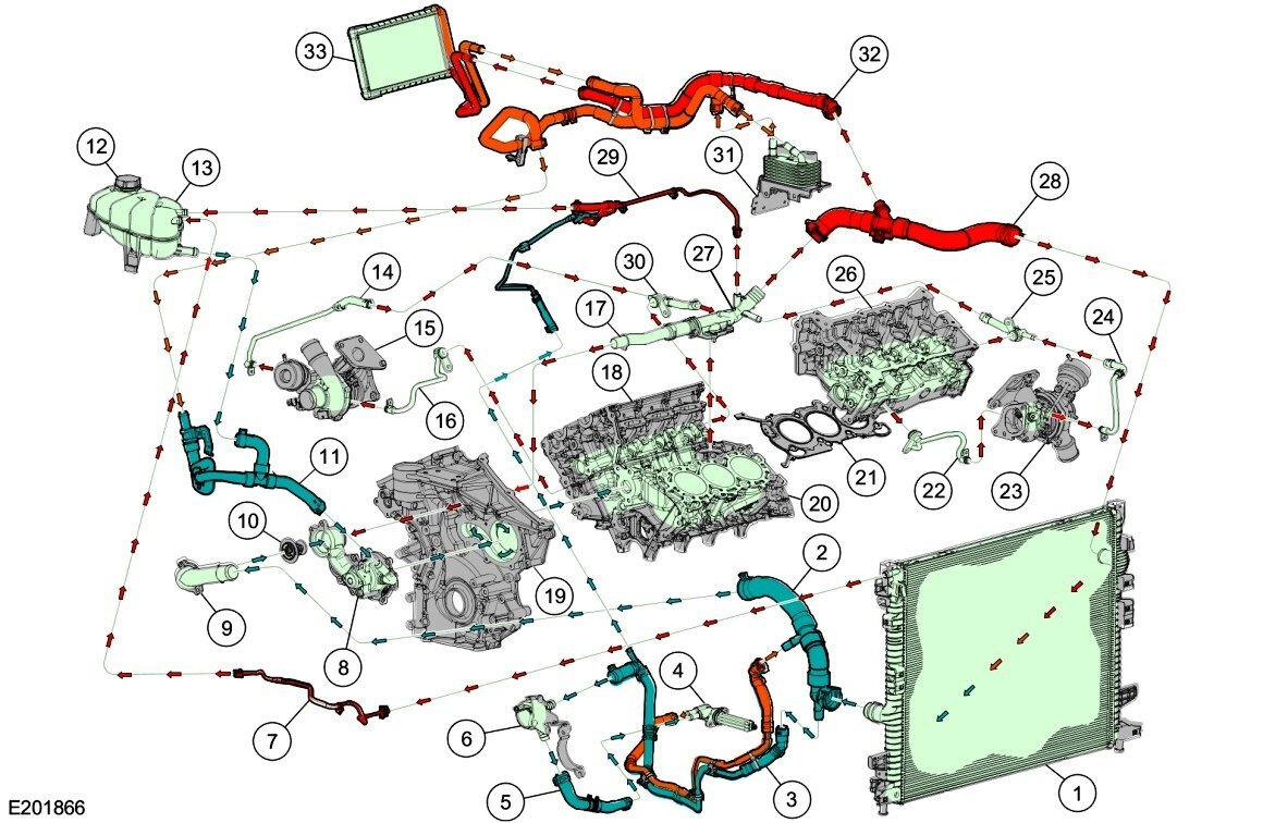

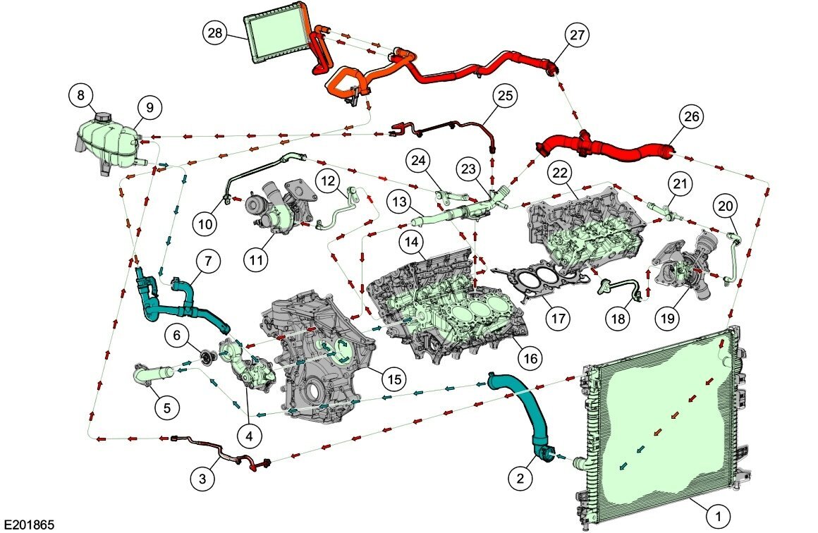

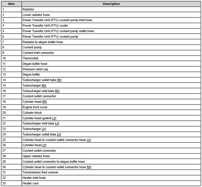

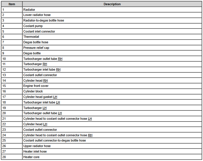

Haz Posted January 23, 2025 Report Share Posted January 23, 2025 (edited) Welcome to the Forum, @clay0708! In addition to the bushing replacement, fulfillment of Safety Recall 22S43 provides for installation of a protective cap... Partial description from Safety Recall 22S43 Service Procedure: Example photo, courtesy of Forum member @doofus... From the 2016 Edge Workshop Manual, comparative 2.7L EcoBoost engine cooling component diagrams... Base & Trailer Tow Hot Market AWD (all-wheel drive) Good luck! Edited January 23, 2025 by Haz 1 Quote Link to comment Share on other sites More sharing options...
