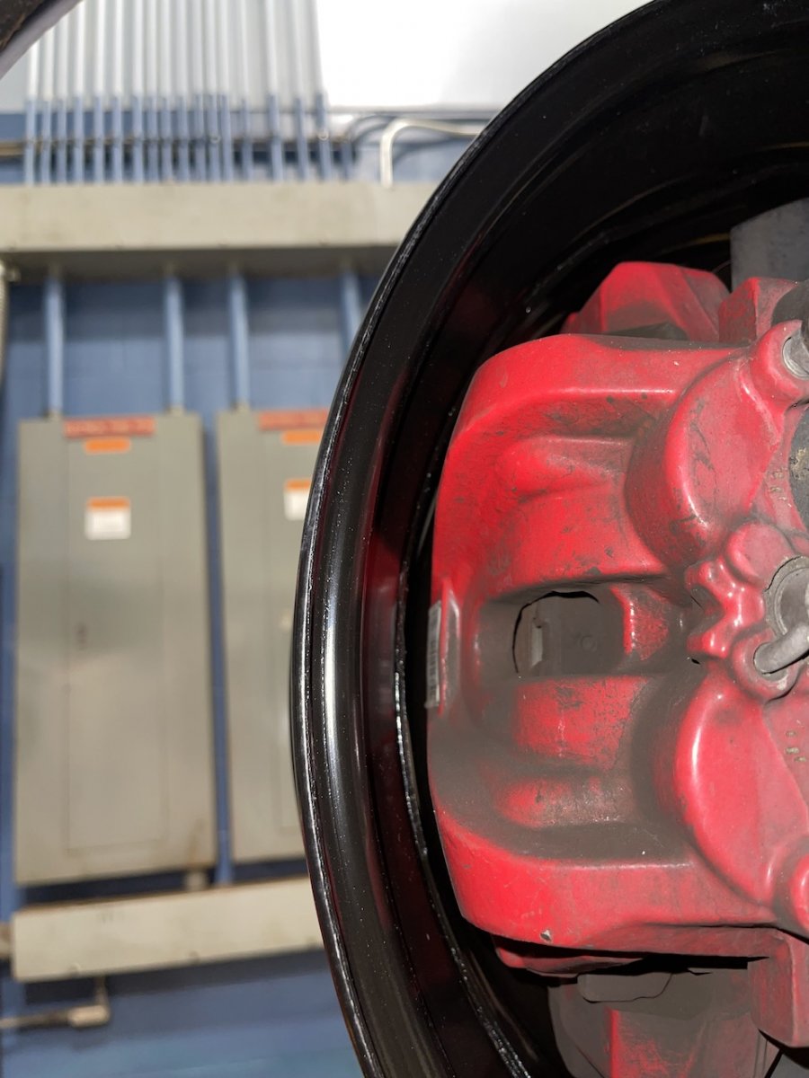

taurussvt Posted December 22, 2023 Author Report Share Posted December 22, 2023 I decided to bite the bullet and buy the spare tire and tool kit. I just confirmed that the wheel fits over the brakes with plenty of space, over a 1/4” between the calipers and the wheel. 1 Quote Link to comment Share on other sites More sharing options...

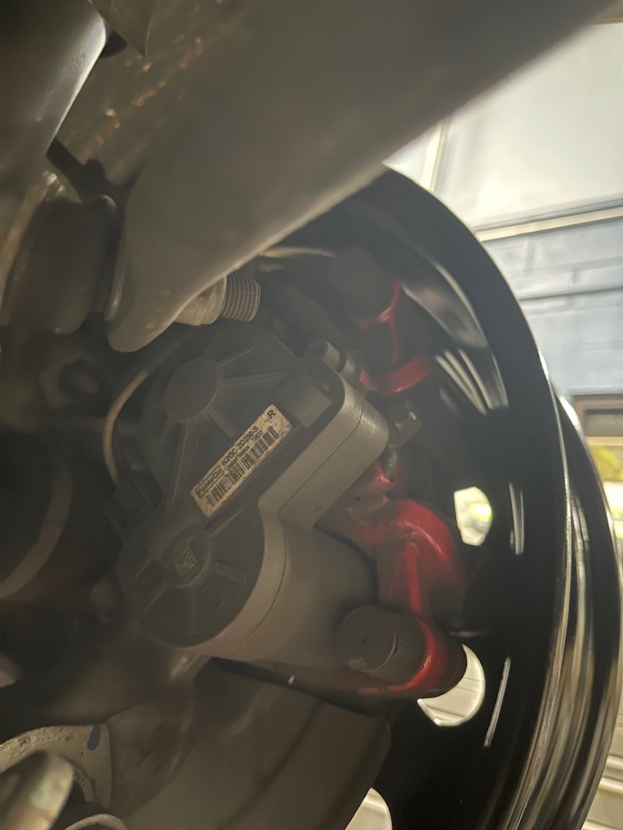

taurussvt Posted December 23, 2023 Author Report Share Posted December 23, 2023 (edited) I know it’s not that easy to tell because of the shadows and whatnot, but there’s about a 1/4” of space between the caliper and the inside of the front wheel. This is on the rear, and there is even more room than the front. Edited January 28, 2024 by 1004ron 1 1 Quote Link to comment Share on other sites More sharing options...
dabangsta Posted December 23, 2023 Report Share Posted December 23, 2023 Thanks for adding the images! I would have thought the rears would be less gap as the EPB usually causes more clearance issues on other vehicles. Unrelated to the spare fitment with ST Performance brakes mostly, I have debated going further than just the larger front rotors (I think FWD and AWD use the same caliper and pads, but a different caliper mount, which seems like the radius of the pads would be odd) and possibly going for the 345mm rotors all around, with the brake calipers in the front with the larger pistons. I don't think it would affect things like the adaptive cruise or emergency braking (it doesn't just blindly apply brakes, it could tell that it might be stopping better and lower the effort). I just don't think I drive the vehicle enough around town to do the work. It is my wife's daily driver, I generally only drive it on the highway on vacations. Should doesn't think it needs new brakes, let alone better ones, and she is really not into red painted calipers. The brakes it has are more than adequate for daily driving and panic braking. I tend to get them to fade most times I drive so I usually have to replace them more frequently and also usually try to do OEM style upgrades (like 13 inch Cobra rotors to replace 10.8 inch rotors on my Lincoln Mark VIII). 1 Quote Link to comment Share on other sites More sharing options...
