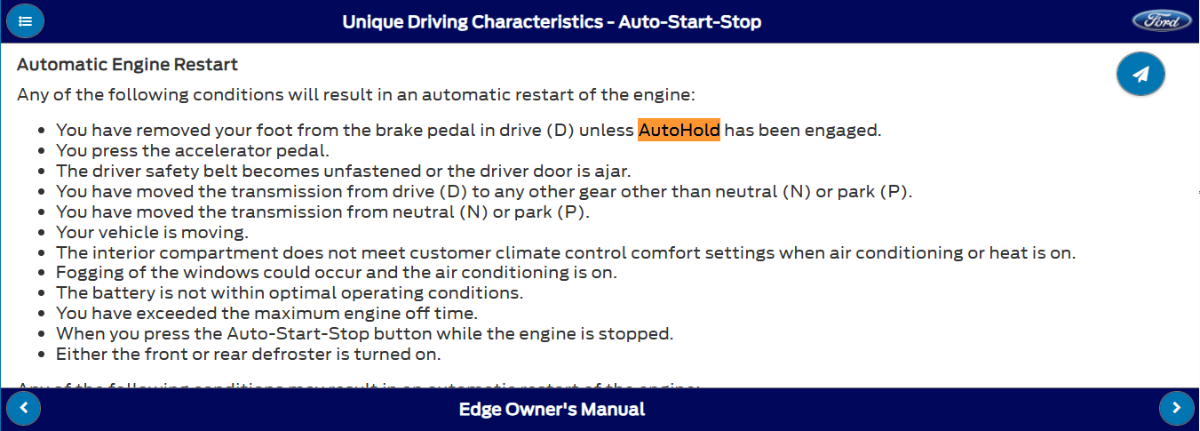

Wubster100 Posted February 25, 2025 Author Report Share Posted February 25, 2025 On 8/12/2024 at 9:03 AM, dabangsta said: The 2023/2024 owners manual has details on it's use, but I have never seen an Edge with it. It isn't in the 2022 owners manual. It is extremely disappointing for Ford to put auto hold in the owner's manual, yet we don't have it on our vehicles. Quote Link to comment Share on other sites More sharing options...

Wubster100 Posted February 26, 2025 Author Report Share Posted February 26, 2025 Yes, auto hold is in the owner’s manual, but it is not equipped on any Edge. Auto hold is available on other vehicles such as the Lincoln Nautilus. Similarly, the Fusion does not have auto hold, but the Lincoln MKZ does. 1 Quote Link to comment Share on other sites More sharing options...

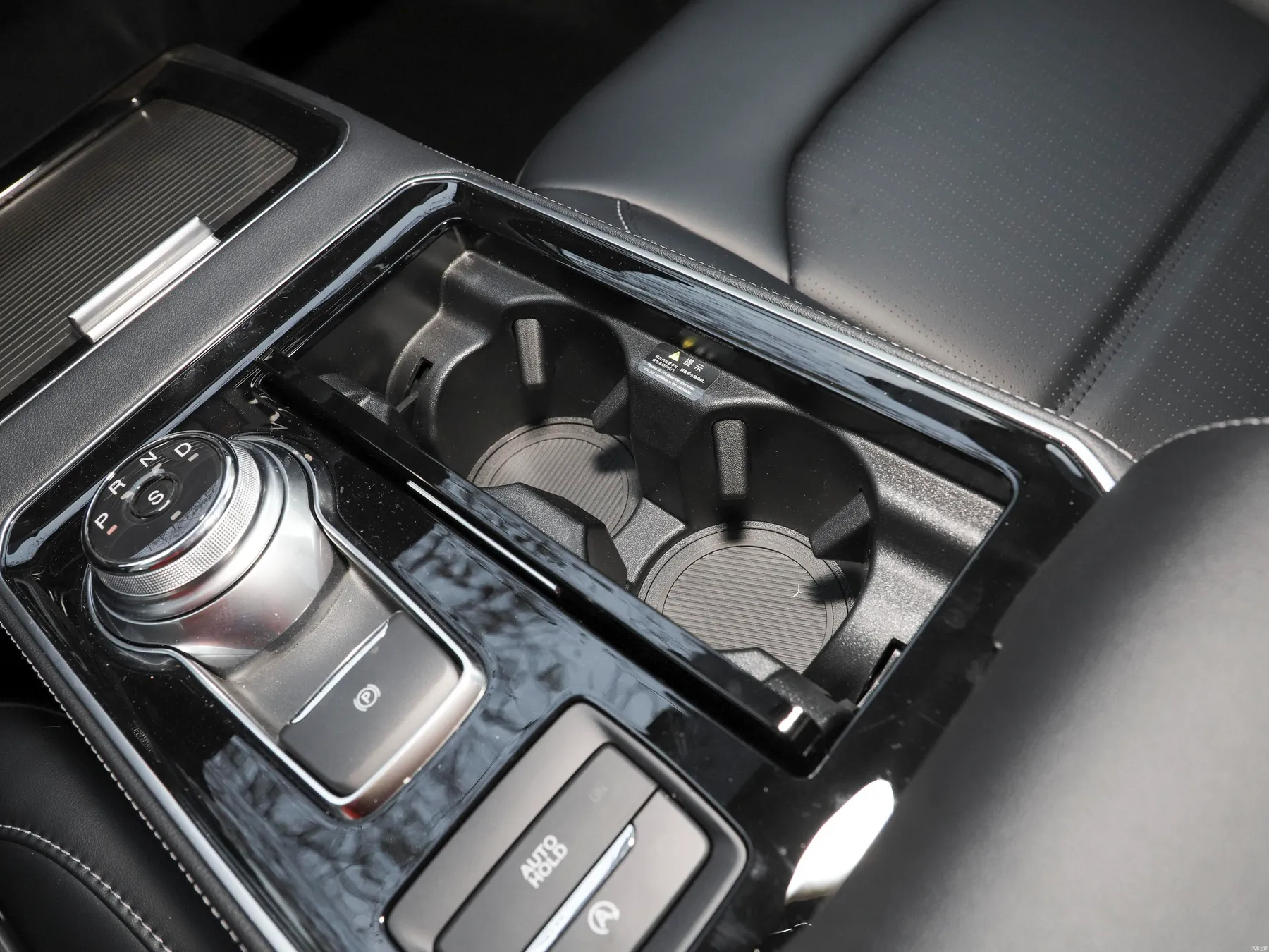

Wubster100 Posted April 20, 2025 Author Report Share Posted April 20, 2025 @HazCan you post the wiring diagrams of the auto hold button on the Ford Edge CN? I am interested to see which module the button connects to. VIN: LVSHFCAH1KH454157 EDGE CN 2.7L Quote Link to comment Share on other sites More sharing options...
Haz Posted April 21, 2025 Report Share Posted April 21, 2025 (edited) For that VIN and generally for 2020 Edge -- which is the latest listed model year shown -- no mention or depiction of AutoHold switch or circuits/connectors in the China region Wiring Resource, though the China region Workshop Manual includes identification of the Instrument Panel Cluster's AutoHold Reconfigurable TellTale (RTT) indicator lamp in an IPC illustration... ...and as you mentioned previously, a single reference to AutoHold in the China region HTML format Owner's Manual, which is the only format in which the Owner's Manual is offered... Good luck! Edited April 21, 2025 by Haz 2 Quote Link to comment Share on other sites More sharing options...
Wubster100 Posted April 21, 2025 Author Report Share Posted April 21, 2025 Anything for the 2019-2024 7 seat Edge? Quote Link to comment Share on other sites More sharing options...
Haz Posted April 21, 2025 Report Share Posted April 21, 2025 2024 Edge Workshop Manual - China region... Placing your device cursor over underlined acronyms may yield popup full-words meanings for acronyms. Auto Hold The auto hold feature is activated and deactivated through the use of the auto hold switch located on the FCIM . For the system to activate, the vehicle must not be moving, the driver safety belt must be buckled and the driver door must be closed. The ABS module receives the driver safety belt buckle status from the RCM and driver door status from the BCM , while brake system pressure and the wheel speed are received from ABS sensors. This information allows the ABS module to determine if the vehicle is stopped. Once the previous conditions have been met the auto hold feature can be activated. When the switch is pressed, the FCIM receives a ground signal from the auto hold switch and sends an auto hold message to the GWM over the HS-CAN3 . The GWM relays the message to the ABS module over the FD-CAN . The ABS module then sends a message to the instrument cluster through the GWM indicating the auto hold feature has been activated and the instrument cluster illuminates the auto hold indicator. The auto hold indicator illuminates when the IPC receives a message from the ABS module through the GWM . Once the auto hold feature is activated and the driver presses the brake pedal, the ABS module closes the isolation valves in the HCU to maintain the current brake system pressure at the wheel ends. The ABS module maintains the pressure until the driver presses the accelerator pedal, shifts the transmission into PARK or after a specific time limit has been reached. The ABS module engages the parking brake after 2-10 minutes, depending on the grade of incline the vehicle is currently stopped on, the steeper the grade, the shorter the time. Auto Hold Switch The auto hold switch is a momentary contact, push button switch and is part of the FCIM . Normal Operation and Fault Conditions Vehicles equipped with EPB are also equipped with an auto hold feature. This feature must be enabled by the driver by pressing the auto hold switch once the driver seatbelt is buckled and the driver door is closed. Pressing the auto hold switch in the FCIM enables the auto hold feature, but does not activate auto hold. When the switch is pressed, the FCIM sends a message to the ABS module indicating the system has been enabled. The ABS module then waits for messages from the RCM and BCM as well as ABS sensor information to indicate the auto hold feature can be activated. Once all criteria has been met, the ABS module activates the auto hold feature. In the case of a system error, the instrument cluster displays messages and icons. China region Search-function is not locating Auto Hold switch and other FCIM controls in Wiring Diagrams or Workshop Manual procedures, and no China-region Owner's Manual is shown. Hopefully, the above verbiage provides you sufficient Auto Hold awareness at this stage of your inquiry. Good luck! 1 1 Quote Link to comment Share on other sites More sharing options...
