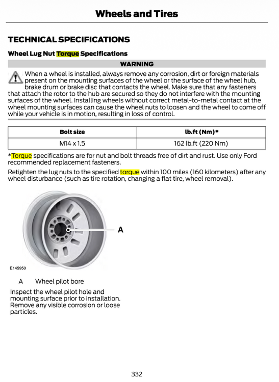

fh4ever Posted March 27 Report Share Posted March 27 hello all, newbie here! just bought a 2024 Edge. I have a question regarding the lug nut torque of 162 ft-lbs... really? why would you need that much? are you guys really torquing the lug nuts that much? It seems to me that would increase the risk of warped rotors? and also, mine appear to have the SS clad lug nuts. (I need to take one off to validate). It seems to me that 162 ft-lbs would destroy the cladding in short order. We swapped out clad lug nuts for solid steel lug nuts on two mustanges when the cladding starting giving issues... and we were only doing 90 ft-lbs !!! would like to hear the comments the fellow edge owners please before I begin rotating the tires.. thanks Quote Link to comment Share on other sites More sharing options...

Samurai Edge Posted March 27 Report Share Posted March 27 Where are you getting the 162 ft/lb number from? Your User Manual? Mine originally stated 150 ft/lbs which I can install & remove by hand, BUT it seems way too high. What I ultimately found out is that the 150 ft/lb value was for trucks, not cars. I now torque to 100 ft/lbs. Haven't had a wheel come off yet. Quote Link to comment Share on other sites More sharing options...

fh4ever Posted March 27 Author Report Share Posted March 27 I have always used 90-100 on everything else. But I want to do this right. The online owners manual show it as 162 (same as above), and the ford service manager and the parts guy both looked it up and came up with the same number. I cannot believe it should be that tight. my two 1/2" drive torques wrenches only go to 150. I find it hard to believe they made a misprint ! Quote Link to comment Share on other sites More sharing options...
fh4ever Posted March 28 Author Report Share Posted March 28 gotter done! tires rotated. The lug nuts came off easy... I would guess the last guy probably used 90-100 ft-lbs. I tightened in 4-5 stages, the last two stages was at 150 ft-lbs and then I turned the handle one more turn...supposedly at 160.... the handle was now off the scale. All done by hand and no impact wrench. The nuts turn very little after 100 ft-lbs and although it was tight, it did not feel too unreasonalble for the m14 thread. The ss clad did not distort any either. I will call it as good enough. Quote Link to comment Share on other sites More sharing options...
Samurai Edge Posted March 29 Report Share Posted March 29 Well, that was fun . . . . Just for yuks, I just did an internet search for the Ford Edge lug nut torque specs, for the years 2007 to 2024. Depending on where you find the information, the torque spec ranges from a low of 79 ft/lbs to a high of 162 ft/lbs ( as shown in the Ford documentation ). Where fh4ever had his Service Manager & Parts guy tell him that 162 ft/lbs is the correct answer, my purchasing dealer Service Tech told me 100 ft/lbs. When in doubt, go with the Service Manual and hope the values specified for any item is correct. Quote Link to comment Share on other sites More sharing options...
fh4ever Posted March 29 Author Report Share Posted March 29 I am sure I will research this again next tire rotation to see if I find anything different. 162 ft-lbs is long ways from 90 or 100 ft-lbs. Here is what Google AI says about an M14 screw: 120–140 Nm (88–103 ft-lbs) for Grade 8.8 to 170–215 Nm (125–158 ft-lbs) for Grade 10.9. Quote Link to comment Share on other sites More sharing options...
Samurai Edge Posted March 30 Report Share Posted March 30 (edited) I agree with you that 162 ft/lbs is too high a number and wonder where that number came from. Your note above also draws interest as to whether or not the Ford manual is showing the correct numbers or not. By comparison, I just looked up the wheel torque numbers for the Ford Mustang, which shows 150 ft/lbs for the 2015 - 2026 model years. " Ford recommends 150 lb-ft for all 2024–2026 Mustangs, including EcoBoost, GT, and Dark Horse trims. " Looking at the 2015 - 2026 F150 wheel torque specs, Ford recommended numbers are 150 ft/lbs. Looking at the Lincoln Navigator 2014 - 2026 wheel torque specs, Ford recommended numbers are 150 ft/lbs. Something is amiss here in the Ford stated torque numbers ( 162 ft/lbs ) for the Edge. The Mustang, Navigator and F150 noted above, all have a 5x114.5 bolt pattern. The Edge, like the Ford Fusion, has a 5x108 bolt pattern The Fusion, from 2006 to the present shows a wheel torque spec of 100 - 110 ft/lbs. However, like the Edge, I also found specs ranging from ~ 80 - 150 ft/lbs. Edited March 31 by Samurai Edge Quote Link to comment Share on other sites More sharing options...

enigma-2 Posted April 5 Report Share Posted April 5 The reason for the higher torque on the 2024 Edge is because it uses larger diameter M14 studs (as compared to the smaller M12 studs found on older Edges and most sedans.) The main reason for the higher torque is because of the weight of the 2024 Edge. This weight requires more force for the wheel to be held to the hub to prevent slipping during for extreme maneuvers like emergency braking. According to published figures, the average weight of a 2024 Ford Edge is 4,122 to 4,525 pounds. (A 2007 Edge averaged 4,073 to 4,282 pounds.) These are "curb weights", to which you must add passengers and their junk. Add high speed on a tight curve and that's a lot of force being restrained on those lugs. If I'm not mistaken, I believe that its the same specification as on the F150. It's extremely important to use a torque wrench when mounting the wheels. Failure to get even pressure across the brake rotor surface will almost certainly cause warping of the brake rotors. 2 Quote Link to comment Share on other sites More sharing options...
Samurai Edge Posted April 6 Report Share Posted April 6 While I don't disagree with what you are saying is possible, 162 ft/lbs for the Edge wheel torque seems high. The Ford F150 and the Lincoln Navigator are both 150 ft/lbs wheel torque. Without looking up the numbers, I'm fairly sure that both those vehicle's weight are equal to, if not greater than, the weight of the Ford Edge. Quote Link to comment Share on other sites More sharing options...
enigma-2 Posted April 6 Report Share Posted April 6 You are correct, the F150 is still 150 (the F250 & 350 are 164 ft.lbs.). I think (but only a guess) that its because the F150 uses a 6-bolt lug pattern and the Edge uses a 5-bolt. The higher torque would be necessary to proved the equivalent holding power. 1 Quote Link to comment Share on other sites More sharing options...
