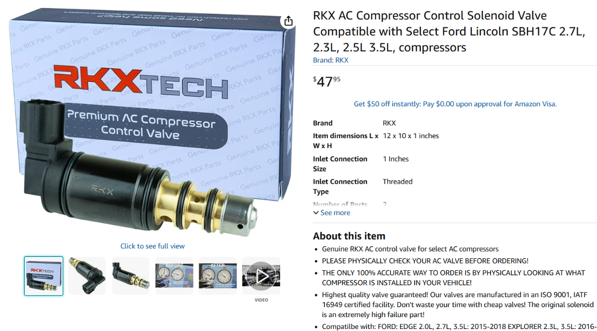

razziel24 Posted April 29 Author Report Share Posted April 29 He mentioned an electronic "compressor valve", and told me that the simptoms related to its failure, are similar to the ones I was describing. It was just a casual conversation, he hasnt seen the car yet, but I wanted to check if this was a common failure. Doing some online research i found this... Quote Link to comment Share on other sites More sharing options...

razziel24 Posted May 13 Author Report Share Posted May 13 Ok, i finaly had time to take the car to the mechanic. The problem was that electronic valve in the AC compressor. They drained the gas, replaced the valve and filled the system back with gas Valve: $75 Labor: $40 The AC is working perfectly now. 2 Quote Link to comment Share on other sites More sharing options...
