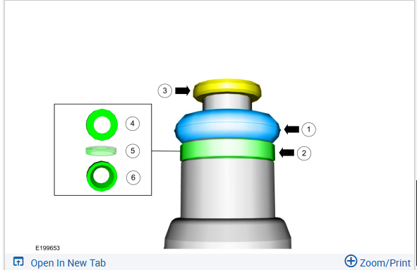

mattP Posted May 23 Author Report Share Posted May 23 Got the car apart again and it's looking like the fuel pressure issue was caused by me. There's o-rings on the injectors and I pinched 3 of them badly. I'm guessing it was pissing fuel out. Back to square one! 1 Quote Link to comment Share on other sites More sharing options...
mattP Posted May 23 Author Report Share Posted May 23 (edited) Just in case someone needs to pull their fuel rails. Here's what the injectors need to look like. #2 and #3 disappeared for all but 3 injectors when I pulled the fuel rail. Long story short, you can order repacements here for half the cost at the dealer. https://www.autozone.com/p/mahle-fuel-injector-o-ring-kit-gs33877/1138481?searchText=fuel+injector+o-rings&productPartGroupId=azpg2374&productBrandId=FLHQ&productPositionId=3159&productUniqueId=9326166490 Edited May 23 by mattP 1 Quote Link to comment Share on other sites More sharing options...
