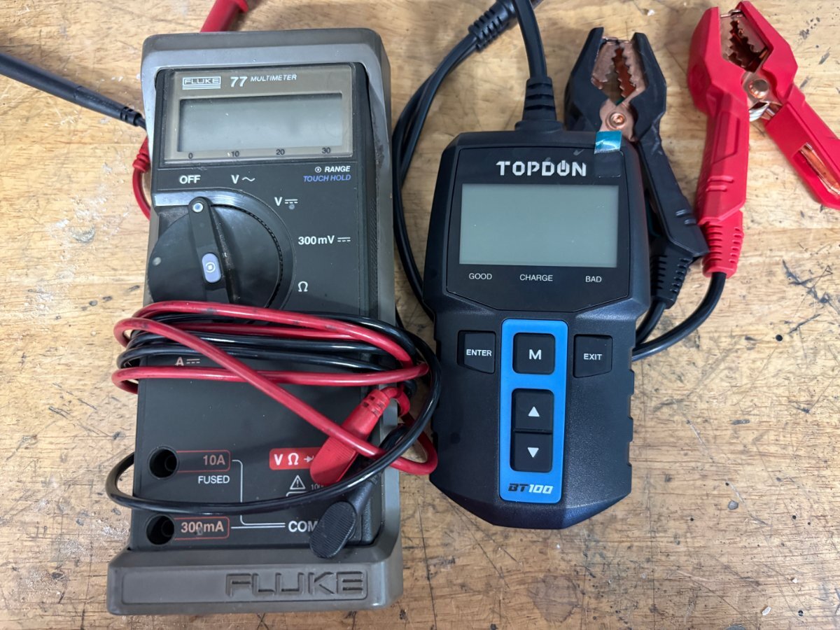

1004ron Posted 1 hour ago Report Share Posted 1 hour ago Any explanation without testing would be a thumb-suck. Testing is what's needed, and the "Autozone" testing suggestion was meant to be an example of the service such stores offer, and most likely some in Canada do the same. A dead/discharged battery could be the symptom of a failed/failing battery or a parasitic drain or a charging system failure. Quote Link to comment Share on other sites More sharing options...
