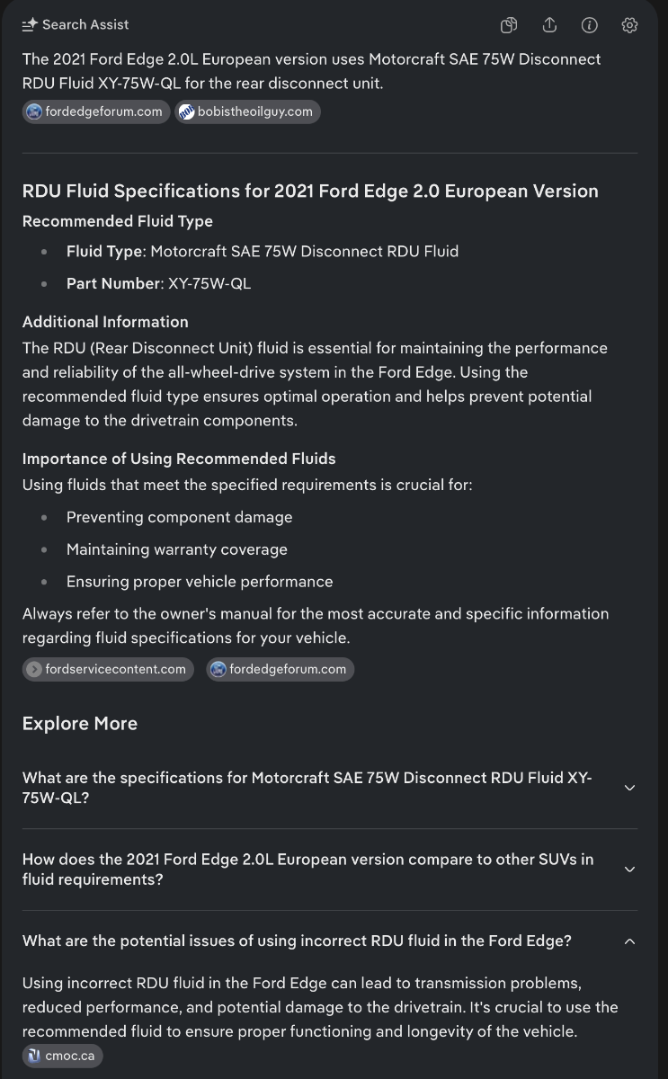

1004ron Posted Wednesday at 08:34 PM Report Share Posted Wednesday at 08:34 PM @garycrist that video shows the RDU type in my 2017 and don't believe it has any bearing on this discussion. I have changed the RDU oil in mine and its regular gear oil which I don't believe will work in the RDU for the model/year Edge discussed in this thread. 1 Quote Link to comment Share on other sites More sharing options...

1004ron Posted Wednesday at 11:19 PM Report Share Posted Wednesday at 11:19 PM 1 hour ago, garycrist said: Thank you, I have edited the original post for clarity. The edits as far as I can tell relate to the RDU in the video, which is the type found in my 2017 Sport, but don't believe its relative to the RDU being discussed in this thread. Quote Link to comment Share on other sites More sharing options...
garycrist Posted Thursday at 12:55 AM Report Share Posted Thursday at 12:55 AM I thought the RDUs were basically the same. With a coupler bolted to about a 7.5 inch differential. Please set me straight! 1 Quote Link to comment Share on other sites More sharing options...
