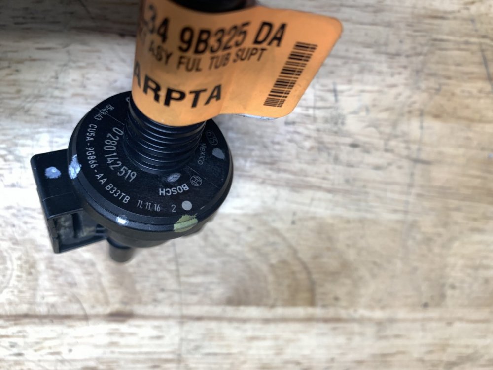

Engine wants to stall - Code P1450 & P144A/C - Evap Purge Valve

I've broken one of these clips and got a replacement from www.oreillyauto.com They don't always have these on the shelf, but they got it in the same day for me - Just let them know the size and they'll order. Dorman OE Solutions Fuel Line Retaining Clip, New Style, Black | 9696916 | Pep Boys 3/8 In. Fuel Line Retaining Clips 800-004: Advance Auto Parts Amazon.com: Dorman 800-041 Universal Fuel Line Retainer - 5/8 In. Compatible with Select Models, 2 Pack : Automotive -
Don't quote me, but I think the inertia switch cuts the fuel pump.
1004ron replied to shumax's topic in 2017-2018 Edge & MKX
Do you still have the symptoms "Car struggles to start after I've refueled it. " ? Hopefully @Haz can assist with that. My dealerships service manager told me the most often the evap valve is the cure, but they have also found the same code to be a problem with the canister in the rear. Once you have it resolved, to avoid this happening again never top-off your tank - stop the first time the pump shuts off. -
If the light is staying on, then no point in clearing codes - check the codes and if its still the same evap code then you have other issues with the evap system, like the canister in the rear. -
