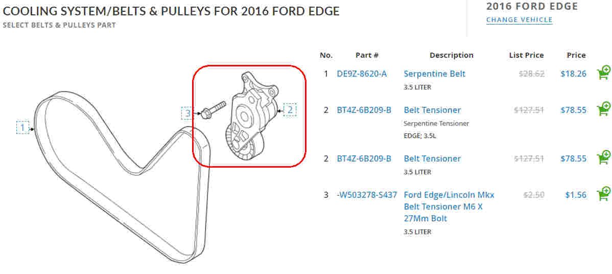

My 2016 3.5L developed a click at idle with roughly 38,000 miles on it (yes, just out of warranty). It was the tensioner. I purchased a new Motorcraft tensioner for $125 and replaced it myself (not too tough). No more click. It now has 60,000 miles.

The bolts were not loose, the spring/idler wheel would jiggle when the air was turned on and it would make a rattling noise. I replaced it with a new Ford part. It still jiggles when the air was turned on, but there was no rattle. Lots of fun getting the belt back one. Tip - Remove the guard you remove for changing the oil and work underneath as well as on top. Finally got it.
It seems like the whole thing wobbles. Based on the picture I posted, are there just two bolts at the top?
See the attached pictures. My 2016 AWD SEL Edge with 37,000 miles (of course, just out of warranty) just developed a rattle under the hood. The part I am pointing at rattles sometimes (you can see and hear it rattle). Sometimes it stops. My guess is it is the idler pulley or possibly part of the air conditioner. Looks like the belt is attached to it or runs under it. I watched it rattle and then stop (i.e. air conditioner clutch rattling when it grabs and stops when it releases?) Note, air conditioner works fine. Thanks ahead for any help
