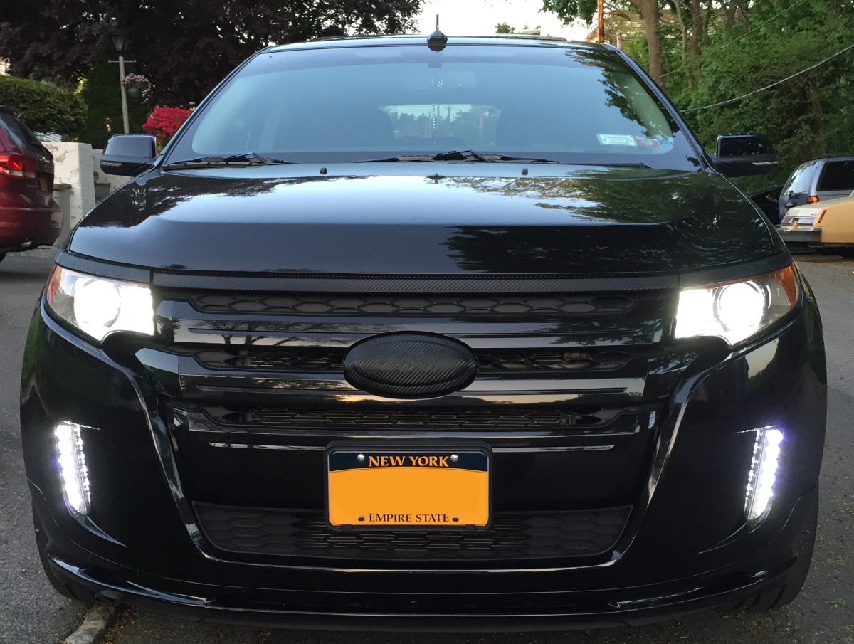

gmfranco88 Posted August 20, 2015 Report Share Posted August 20, 2015 (edited) Hell Lupid, I remember when I was searching for a way to remove that chrome piece between hood and grille I would search for Chrome Trim, and for the ones above the headlights i would search for Headligh Chrome Trim, etc. I ended up wrapping it in Carbon Fiber Vinyl. Edited August 20, 2015 by gmfranco88 Quote Link to comment Share on other sites More sharing options...
LUPID Posted August 21, 2015 Author Report Share Posted August 21, 2015 That looks great franco. So I guess I can just vinyl wrap it, regardless of what they call it.Did you have to remove the trim to wrap it?L Quote Link to comment Share on other sites More sharing options...

gmfranco88 Posted August 24, 2015 Report Share Posted August 24, 2015 Lupid, I did not remove any of the pieces. Although that would have made the process much easier. It took me about an hour to wrap it, specially since i wanted the pattern to match from the center trim piece to the left/right pieces. Because of the curvature of the trim pieces over the headlights, these need a little more time and attention while heating the vinyl to properly maintain the pattern without stretching the vinyl and causing it to warp. From what I saw, the center trim pieces is easy to remove. There are only a couple of screws and a clip to remove the center trim. The trim on top of the headlights also have screws that can be removed, however, one of the screws on each side is convered by the side fenders. I didn't see a way to remove the headlights without removing the bumpers, thus the reason why I decided to do it without removing the pieces. Quote Link to comment Share on other sites More sharing options...
