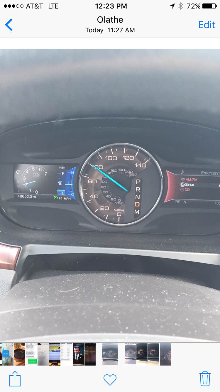

bherm Posted September 25, 2015 Report Share Posted September 25, 2015 See Attached Photo Speedometer/Cruise MPH 80/74 mph 50/50 mph 45/45 mph 40/37 mph I've had the vehicle in to two different Ford Dealerships and they have calibrated it twice and recently updated the software with a new SD card. Can someone please teach my how to read a speedometer? Quote Link to comment Share on other sites More sharing options...

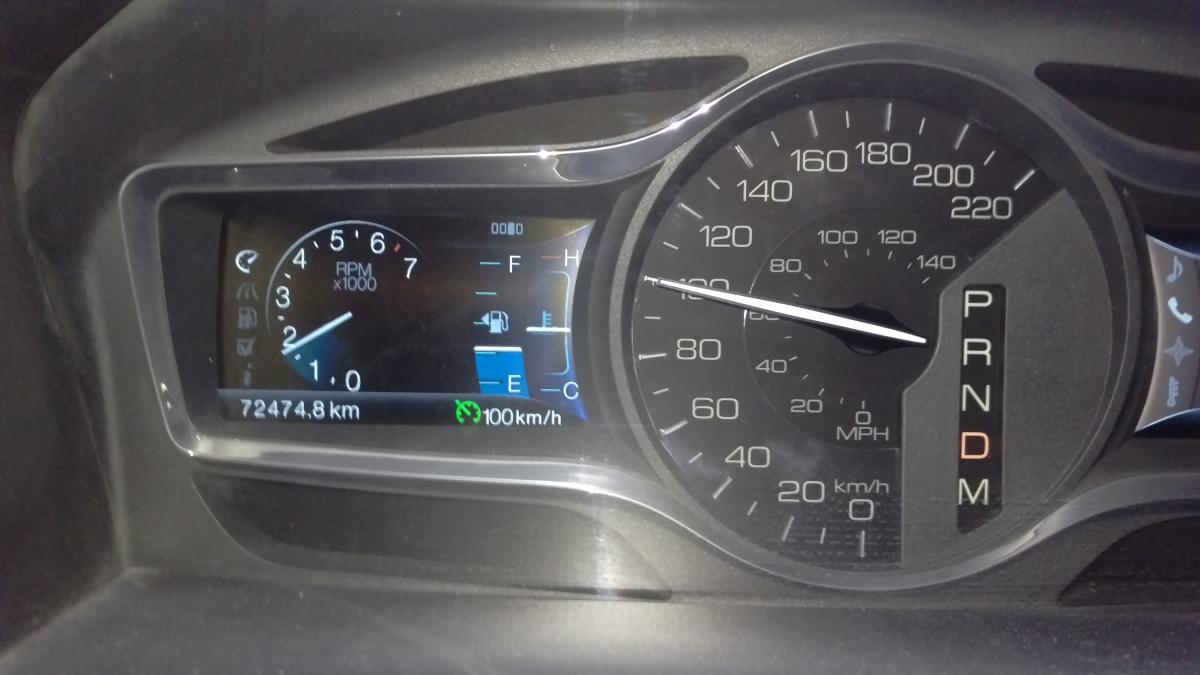

omar302 Posted September 27, 2015 Report Share Posted September 27, 2015 (edited) The OP's issue is the difference between the speedo needle indicated speed vs. the cruise control set speed. In my opinion, the needle is not calibrated correctly. It is definitely not right. Will try to confirm it with my car. Also note that it will not have any relation to the tire size. The difference is in 2 outputs of the cluster itself. Edited September 27, 2015 by omar302 Quote Link to comment Share on other sites More sharing options...
omar302 Posted September 27, 2015 Report Share Posted September 27, 2015 Confirmed. 100 km/h & needle at exactly 100 km/h. 1 Quote Link to comment Share on other sites More sharing options...

bherm Posted September 28, 2015 Author Report Share Posted September 28, 2015 Yes they are OEM tires.. Ford is in the process of looking into the issue. The digital readout is correct in my opinion because it is the closest to "Speedometer" app on my phone. If Ford cannot resolve the issue they said they might buy it back. Anyone know how that process works? And for the record I like my EDGE... Quote Link to comment Share on other sites More sharing options...
