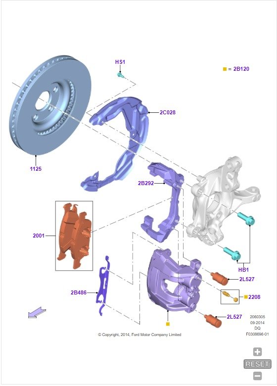

They should give you corresponding part number for the rotor. From the part umber you'd be able to know which size you have. From here, it looks E1GZ-1125-F is 17" (smaller size) and K2GZ-1125-B is 18" (the bigger size).
Also, if you register on http://www.etis.ford.com/, you can check with your VIN, Vehicle Summar, Minor Features, it should list something like "Brake Disc 18 Fr Vent/17 Sol Rear"

great thx, this was helpful!

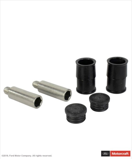

Anyone know the size of Allen wrench needed to remove the caliper bolts?
Take a look at the last post on the first page of this thread.
Found it, thx!
TL;DR
11mm, or 7/16 is a good fit too
