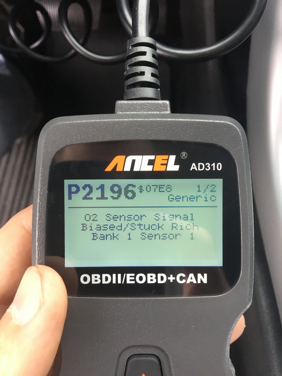

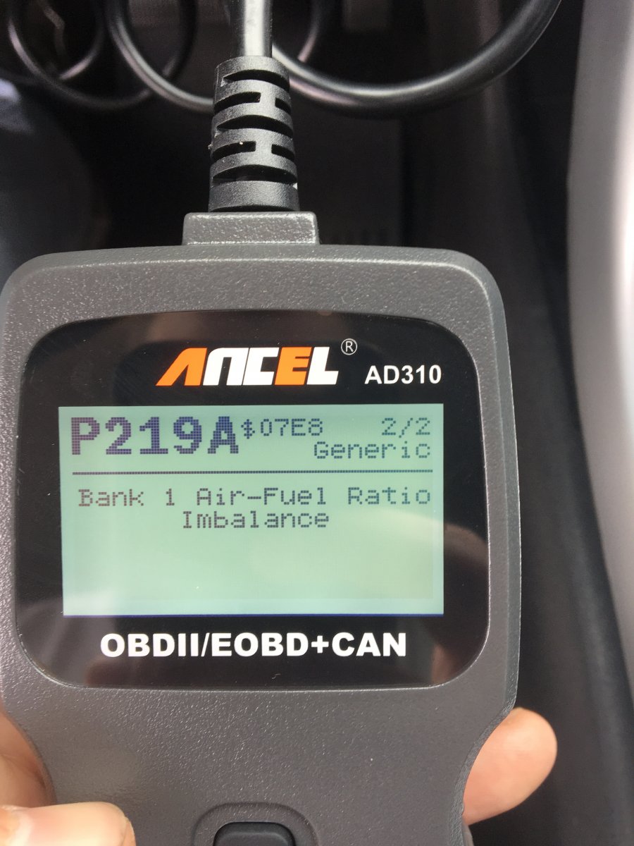

vtchopperdude Posted February 18, 2020 Author Report Share Posted February 18, 2020 2 hours ago, akirby said: I'm not aware of any automatic engine shutdown for low oil pressure. I think it's the shutdown triggering the oil light and the throttle body is the most likely culprit. Ok, you guys are AWESOME!!! This is why I love forums; helping each other diagnosis problems. Soooooooooooooo...................the car has been doing this shutdown almost once a day now, and my wife is afraid to drive it. So, I drove it to work today. It started fine, no issues, and drove to work without issue. I started the car fine at lunch and drove to a gas station to fill up. After the fill up, I hit the start button and the starter just cranks over and over and over and over. No start. I try again, same thing, the starter just cranks, and cranks, and cranks. I sit there for about a minute pondering what is happening. I try again, and it cranks, but stumbles to start, and then finally kicks over. I drive it home. As I'm pulling in the driveway, it shuts itself down again. This is where the oil pressure light comes on. My wife has just given me the run down of " the oil pressure light comes on and then the car shuts down." I think you guys are correct, in that the car shuts down, which triggers the low oil pressure light, which tricks you into thinking that's the issue. With that, I pulled the codes. I get 2 codes. P2196 - O2 Sensor Signal Biased/Stuck Rich, Bank 1 Sensor 1 P219A - Bank 1 Air-Fuel Ratio Imbalance With that, I guess I'm having an 02 sensor issue that is giving an incorrect reading, and messing with the mixture. Again, this shut down issue only occurs at low speeds when slowing down and the car is essentially idling. With that, am I just looking at swapping an O2 sensor here??? 1 Quote Link to comment Share on other sites More sharing options...
vtchopperdude Posted February 18, 2020 Author Report Share Posted February 18, 2020 Ok fellas, so I changed the O2 sensor and it cleared the P219A code. However, I still have the P2196 code. Looking at some other threads, it sounds like my symptoms (hard start after getting gas) may be pointing to the canister purge valve. However, I can't seem to find the part for the 2.0L. I stopped by Napa and they have the canister purge valve for the V6 engines, but not the I4. But again, the 3 symptoms of the leaky purge valve (hard start after gas, running rich, and rough idle) are occurring on my Edge. Any advice on this? I do NOT have a code for a leaky canister purge valve however. Thoughts? Quote Link to comment Share on other sites More sharing options...
vtchopperdude Posted February 19, 2020 Author Report Share Posted February 19, 2020 So, it looks like I need part 9U5A-9G866-AA, which seems to be very hard to find. I tried all the local automotive stores in town and not only do they not have it, but they can't get it. I'll try the dealership in the morning, but I have a feeling they'll have to order it. If the valve is the issue and truly causing it to run rich, then I don't want to keep driving it and foul up the brand new O2 sensor. Quote Link to comment Share on other sites More sharing options...
omar302 Posted February 19, 2020 Report Share Posted February 19, 2020 Just in case you didn't already do it, but did you try to clear the code and see if it then comes back? Might just be a stored code from before. Quote Link to comment Share on other sites More sharing options...
vtchopperdude Posted February 19, 2020 Author Report Share Posted February 19, 2020 8 hours ago, omar302 said: Just in case you didn't already do it, but did you try to clear the code and see if it then comes back? Might just be a stored code from before. Yep, tried 3 times. Drove it around the block, cleared, then came back. Drove to autozone, cleared it, then it came back. Drove to advance auto, cleared it, then it came back. With the hard start after fueling, the purge valve issue seems feasible, especially with the "stuck rich" verbiage in the code. Thoughts? Quote Link to comment Share on other sites More sharing options...
