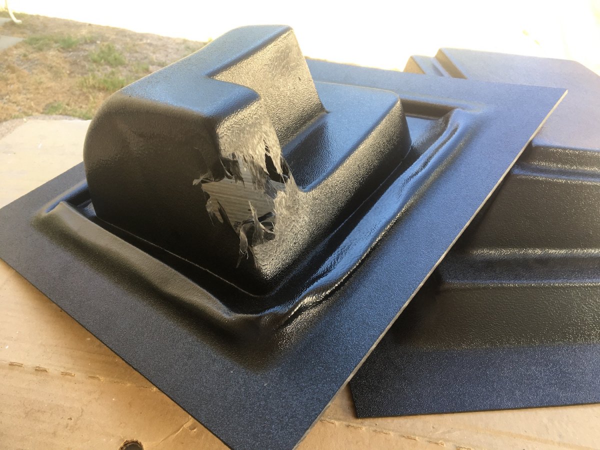

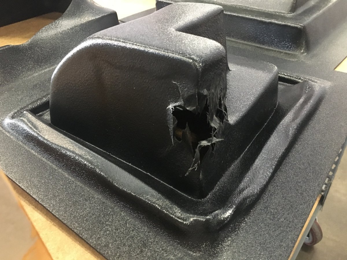

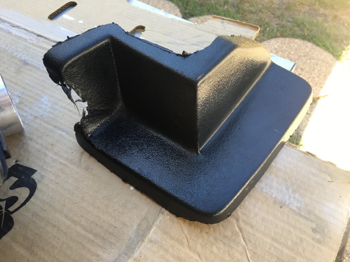

Today I picked up the test parts from the plastic shop and there were some problems with what I call the patch mold. It is much taller than the adaptor mold and I need to make the wood box larger so that there is more plastic to pull  around the taller part. The adaptor mold worked fine as is. I will make the patch mold box the same size as the adaptor mold box,  that will save on set up fees as only one set up will be necessary for both .
One of the tests was a complete fail and blew out the ABS completely . Out of 4 attempts only one was good enough to test.
This was the best of 4.

I was able to cut out a test part from this mess.
Here is the part that is used .

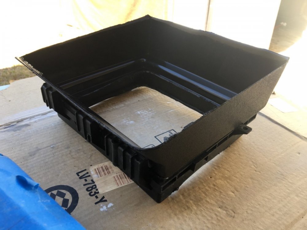

This is the test fit of the part on the V3 bottom half and it fits just fine. I just need to tweek the wood box part of the mold, then it will be ready for testing again.

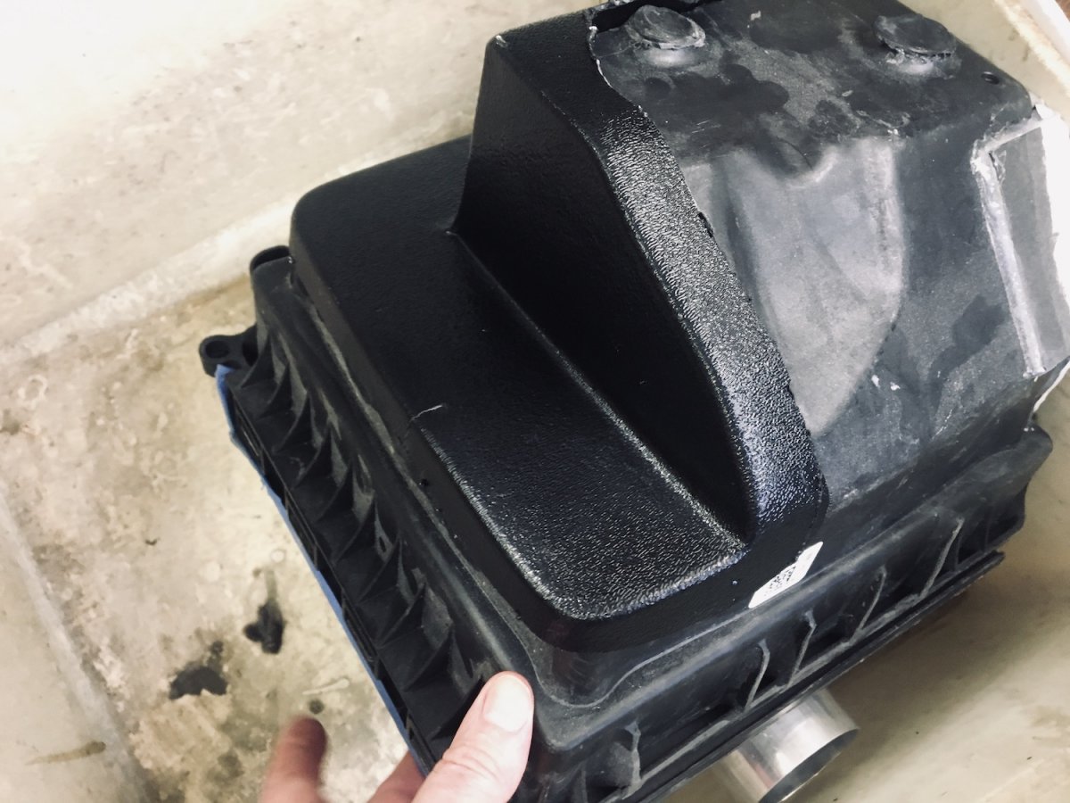

This is the complete V3 air box assembled, looking at the side with the patch. Of course I will clean up the cuts and make then straight, but this is just quick test fit. This will never be seen as it is on the bottom side of the air box. I am liking this method over the adaptor.

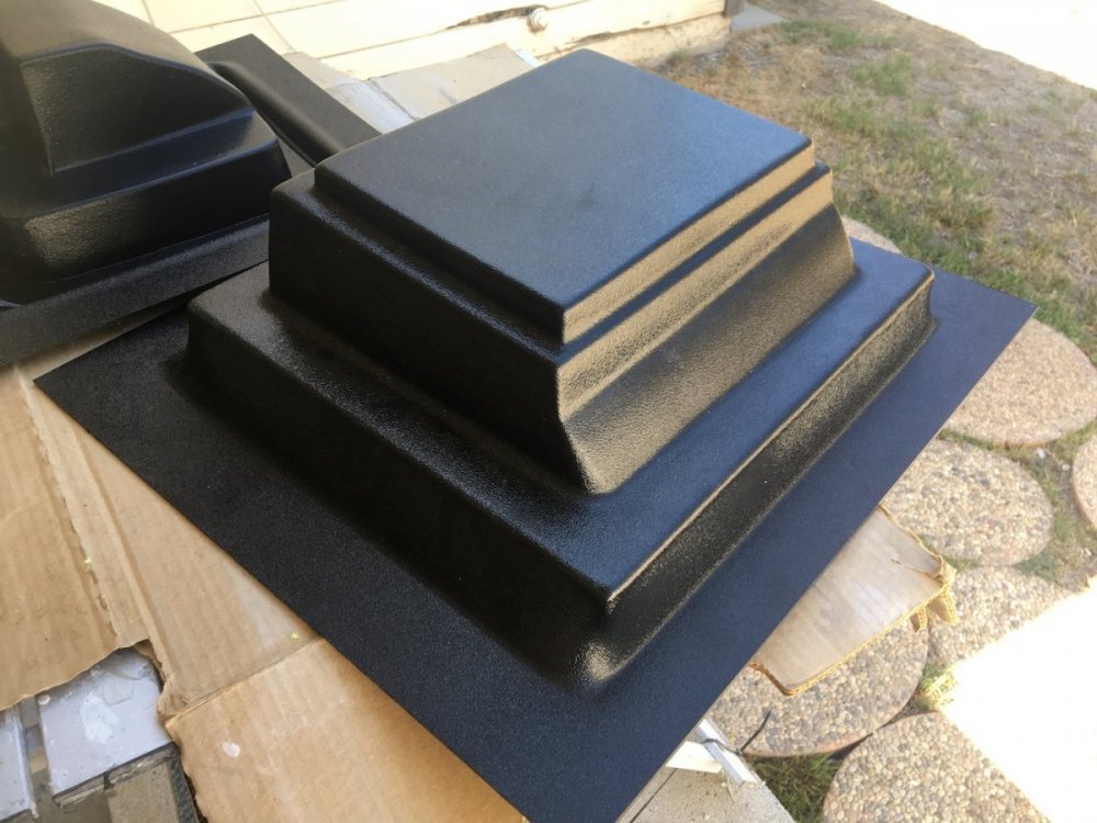

Here is the adaptor, the mold worked as designed and made a good part. No mods are needed, and it is ready to go.
Here is the adaptor rough cut, ready for testing.

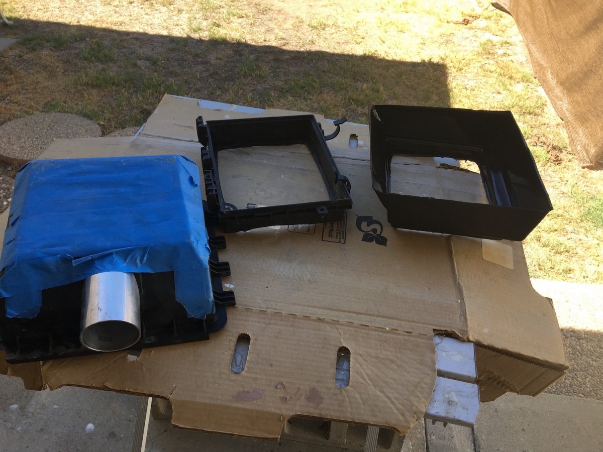

The three parts from L to R:   1. The V3 top half .    2.  Top of the stock air box bottom half .  3. The adaptor

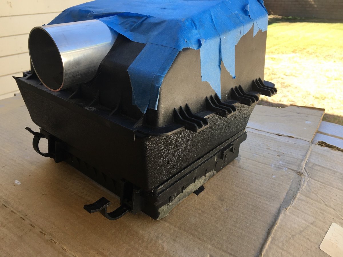

The assembled V3  air box top half,  the adaptor, and the stock air box. It fits and works, but needs clamps ,and latches, and gates ,and and and .... This is why I like the patch method better.
This method may fit on cars that the custom V3 air box bottom half won't fit into. This method uses the OEM bottom half of the air box and the V3 filter top half.

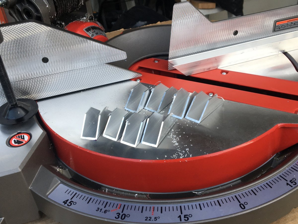

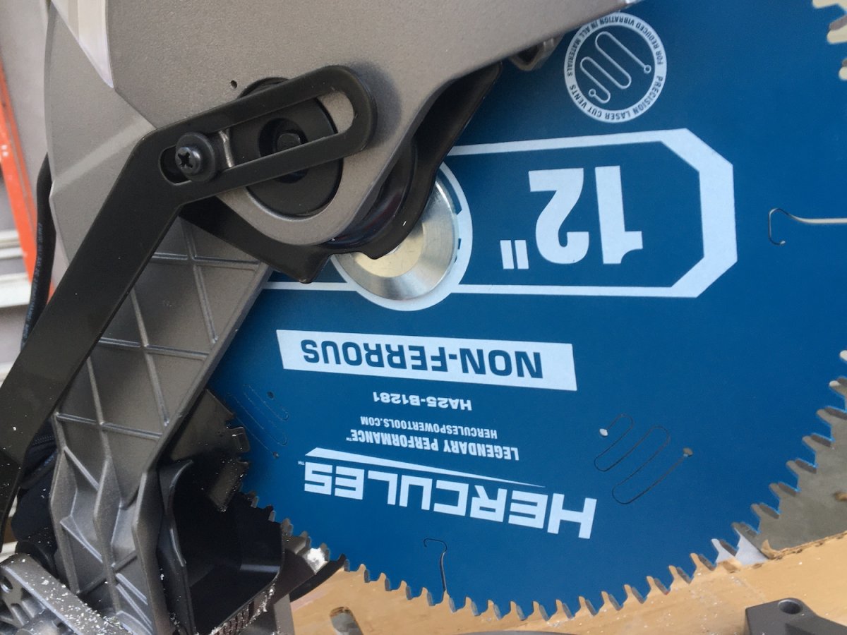

Bought a new 12 inch compound miter saw at Harbor Freight today and tested it out by cutting some latches. I was able to cut out 8 of them quicker than I made the first one by hand. It cuts clean with a special blade made for cutting nonferrous metal. This tool is going to save a lot of time.

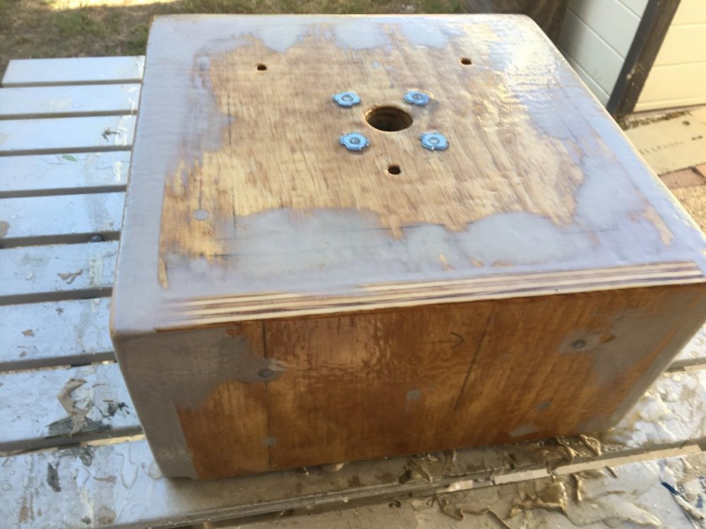

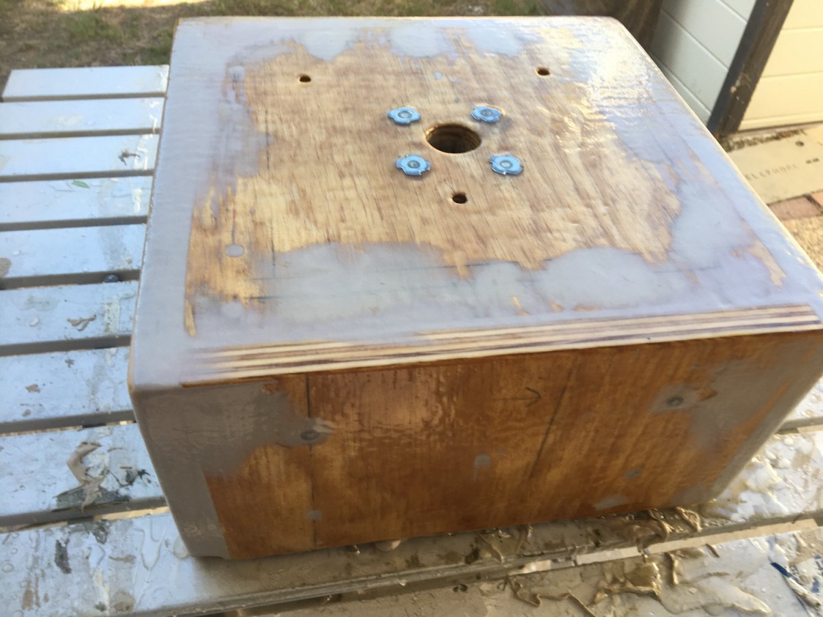

I just finished putting a finish coat on the new wood base for the Patch mold just in case the kit idea takes off . I need to make a good patch part for mine anyway, even if the kit idea flops.
I added 3/4 inch plywood all around to increase the base size. That way there is more plastic available to cover the mold. If it is not enough I will have to rebuild the wood base from scratch .
