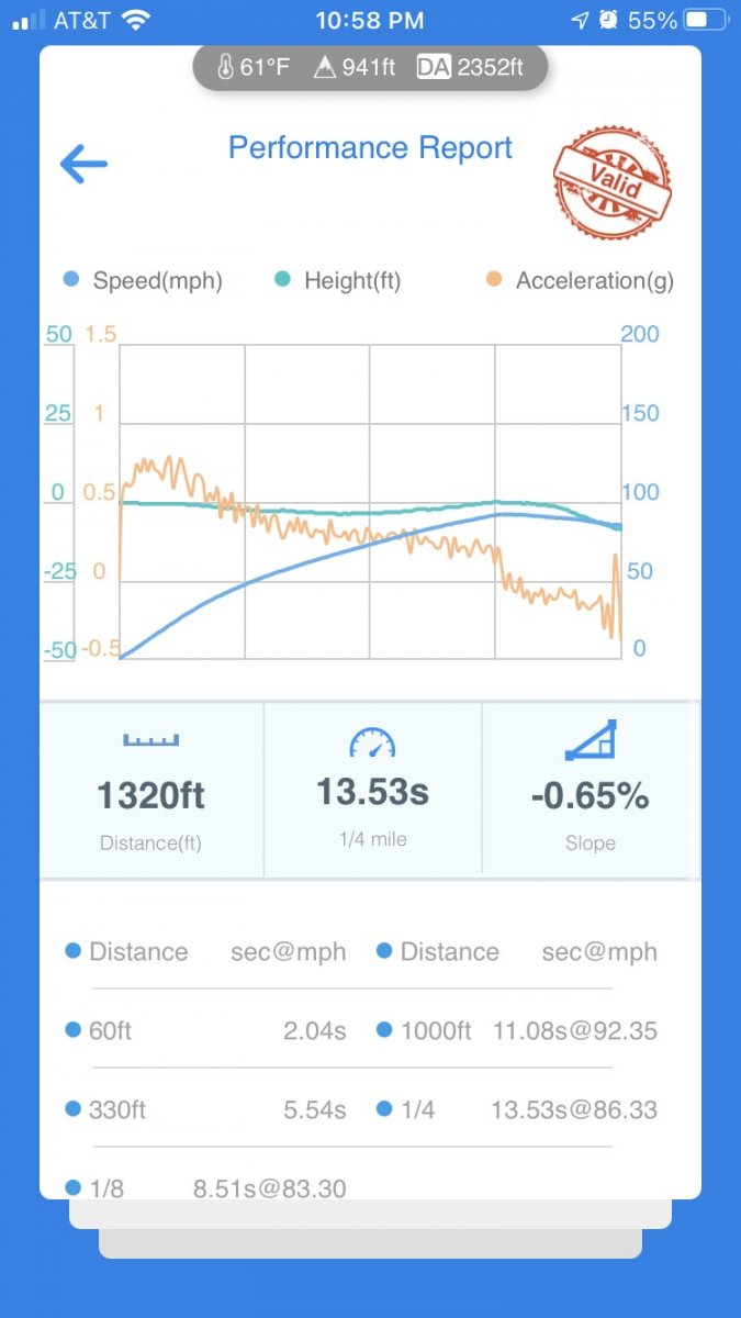

Stage 3 E30 Tune
Ricer Excuses/Relevant info:  Tires are Uniroyal Tigerpaw A/S 245/50R20's right @ 40psi.  Stock RMM, K&N Drop in filter, Boomba VTA adapter, tune.  I'm actually bummed about this run as its my all time best.  On the stage 3 E30 tunes, there was less torque down low, and more up top, so the launch could be feathered if I did it juuuuust right, and the results speak for itself.  I got a REALLY good launch, still broke loose a little as to be expected with these tires, and the pass felt incredible.  But I panicked and started to brake HARD where you see the massive dip at the end there, aborting the run.  I was floored when I still got a 13.53 @ only 86mph! So then I found out that LMS was now quietly updated their tunes to a Stage 4, that everyone on the facebook groups was raving about, so I decided to try it out.  During this time while waiting, I upgraded to the CP-E rear motor mount.

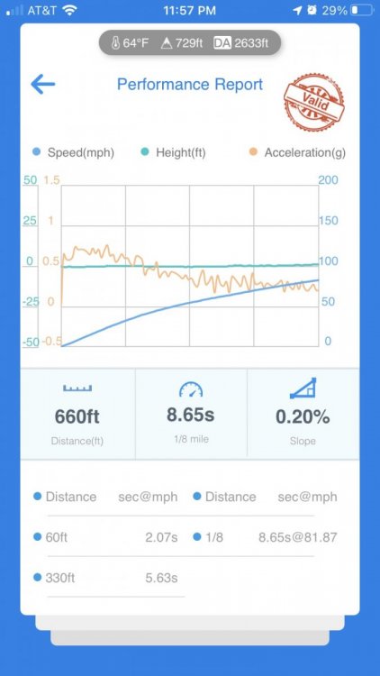

Slight update. Never got to go to the track yet with the stage 3 or stage 4 stuff. I did manage to find a good road for 0-60 use and tested the stage IV 93 octane tune. I got what I’d consider a decent launch but still heavily, HEAVILY feathering it... and well, results speak for themselves.
Not bad! Stock intercooler, 245 all season tiger paws, full weight, yadda yadda yadda.
Can’t wait to try it out with some new much wider stickier tires, and the ultimate performance intercooler!
I will eventually get back to the track to try out the old stage 3 E30 tune and the stage 4 93 tunes. Thought some would appreciate at least some hard numbers.
EDIT: Oh I forgot to mention I did go to the track on the stage IV E30 tune and this was my best time. Dragy said like 8.63 actual time slip reads as pictured. I ran it all the way out to a 1/4 and dragy said 13.6 or so. I’m gonna post another dragy SS that shows the stage 3 E30 tune later that same night.
my conclusion so far is honestly for stock intercooler, stick with the stage 3 E30 tune. Stage 4 is for people with the upgraded intercooler.
