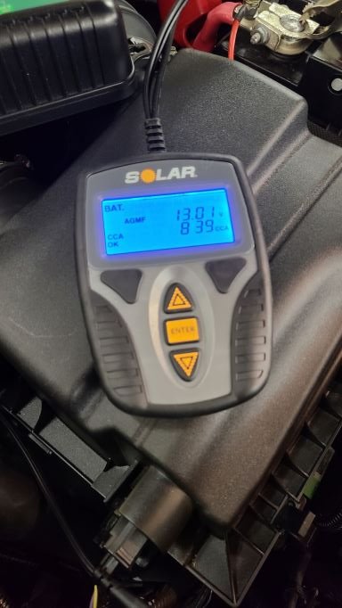

Just received it this morning from Amazon. It can test AGMF, AGMS, Conventional, Gel and Deep Cycle batteries. It also does starting and charging system tests.
I tested it out on my Mustang which has the original 11+ year old battery rated at 590 CCA. It tested at 558 CCA (OK)

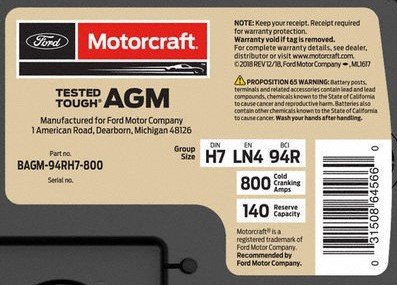

Then I gave it a try on the Nautilus which has a 800 CCA rating. It tested at 839 CCA (OK).
With 3 cars and a motorcycle I figured its a good investmet at $55.

I have this model as well. You can also test your charging system using this equipment. If memory serves (been awhile) you connect it, switch to charging system testing and start your engine.
I'm curious as to why your getting 839 CCA on a battery rated as 800 CCA. I've never seen a battery showing a higher charge than its rating.

It's less than 5% over the rating so well within manufacturing tolerances. The Mustang battery as old as it is is only 5% under spec. I think it's fair to say that low usage, favourable climate conditions and a maintenance charger are key to it's longevity.

Anyway, seen you are using a Motorcraft AGM battery. I might consider going this route as its such a pain to change. Care to share a ballpark as what it costs? Her car takes a group 75, 650 CCA.

It's the original battery. No idea what the replacement cost is.

Understood. Just never seen a battery at or near its 'as manufactured' rating.
Thinking you may have an 850 CCA rated battery installed. But I'm only guessing.
odyssey will always test about 20% higher than rated.  using virgin lead helps a lot.  non-virgin lead based agm batteries may start off 10% higher but wont hold over the longterm.  just my experience.
