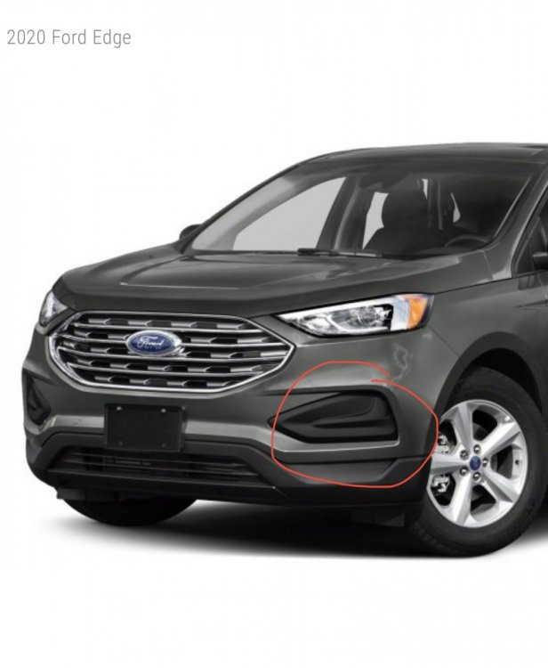

2020 SE aftermarket fog lights
Has anyone been successful with modifying an SE with those bumper 'place-holders' where higher trims have OEM fog lights?  I would like to put fog lights in those spots.  However, I am learning that attempting to put OEMs in there would be pretty costly.  I also do not want to have to remove the bumper cover if possible.  Wondering if anyone has either discovered an easy aftermarket solution or has had luck with a DIY custom job.  It seems like the angle of this area would make it difficult to slap a basic aftermarket setup.
Any insight and advice would be much appreciated!
The OEM ones are a weird shape that only take up a slot on the outer edge. Probably cost prohibitive and some parts like the cover are on back order, to replace them with OEM fog lights ($105 each), the mounts ($140 each), and the cover ($170 each). They are pretty effective, they seem to fill a lot of the area that the weird OEM LED headlights leave shadows.

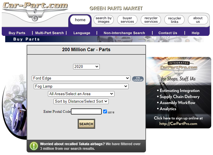

If you'd like to research used parts as an alternative to new, the Car-Part.com salvage yard search engine might yield a source in your area.
Most listings provide photos of the donor vehicle & offered part, its condition grading & pricing, as well as contact information for the selling salvage yard.
In my area, pricing varied widely, from $45 to $85 to $235 per left or right assembly -- so make sure you know exactly what you'd be getting for your money.
Good luck!
