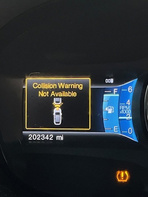

danwdc Posted September 27, 2023 Report Share Posted September 27, 2023 I bought a 2013 Ford Edge Limited AWD last June with a warning the reads "Collision Warning Not Available." When I try to turn on the cruise control, I get a warning that says "Adaptive Cruise Not Available." Both show up on the screen to left of the steering wheel. I replaced the cruise control distance sensor with a Dorman 601-726, leveled it, and set it with a drive with Forscan. Forscan said the calibration was successful. But no change with the 2 alarms and cruise control won't turn on. When I go to the driver assist menu, the adaptive cruise control setting is highlighted lighter than the rest of the options, and when I select it, I am unable to turn off adaptive cruise control. I really don't care if the collision warning or adaptive cruise control work or not, I just want regular cruise control and get rid of the warning lights. Any help would be awesome. Thanks! Quote Link to comment Share on other sites More sharing options...

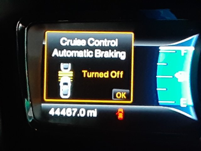

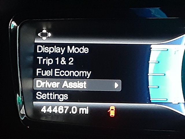

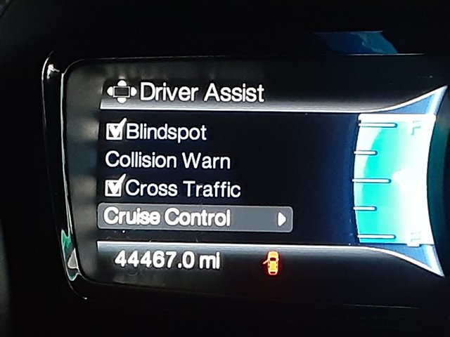

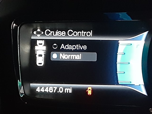

danwdc Posted November 20, 2023 Author Report Share Posted November 20, 2023 Thanks for the reply. When I get the the screen in your second picture, I can't select anything. The Cruise Control selection is greyed out and won't let me proceed. I think I need to add my vehicle VIN to the new cruise control distance sensor with Forcan. I am new to Forscan, and can't figure out how to add the VIN. Any help would be great. Either to add the VIN or delete the adaptive cruise control. Quote Link to comment Share on other sites More sharing options...
omar302 Posted November 21, 2023 Report Share Posted November 21, 2023 7 hours ago, danwdc said: Thanks for the reply. When I get the the screen in your second picture, I can't select anything. The Cruise Control selection is greyed out and won't let me proceed. I think I need to add my vehicle VIN to the new cruise control distance sensor with Forcan. I am new to Forscan, and can't figure out how to add the VIN. Any help would be great. Either to add the VIN or delete the adaptive cruise control. Not being able to select anything, tells me maybe someone changed some configurations (As Built Data), hence why it is greyed out. This is a guess only. For programming the VIN, it would be easier to just download the factory As-Built Data (ABD) from MotorCraft Service site (link) and then use the restore function in ForScan. Do it for all modules you suspect have been altered, at-least for the CCM, IPC & BCM (Cruise Control, Instrument Cluster & Body Control) modules. 1 1 Quote Link to comment Share on other sites More sharing options...

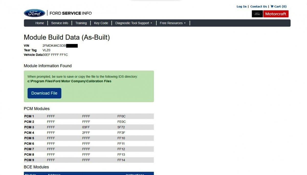

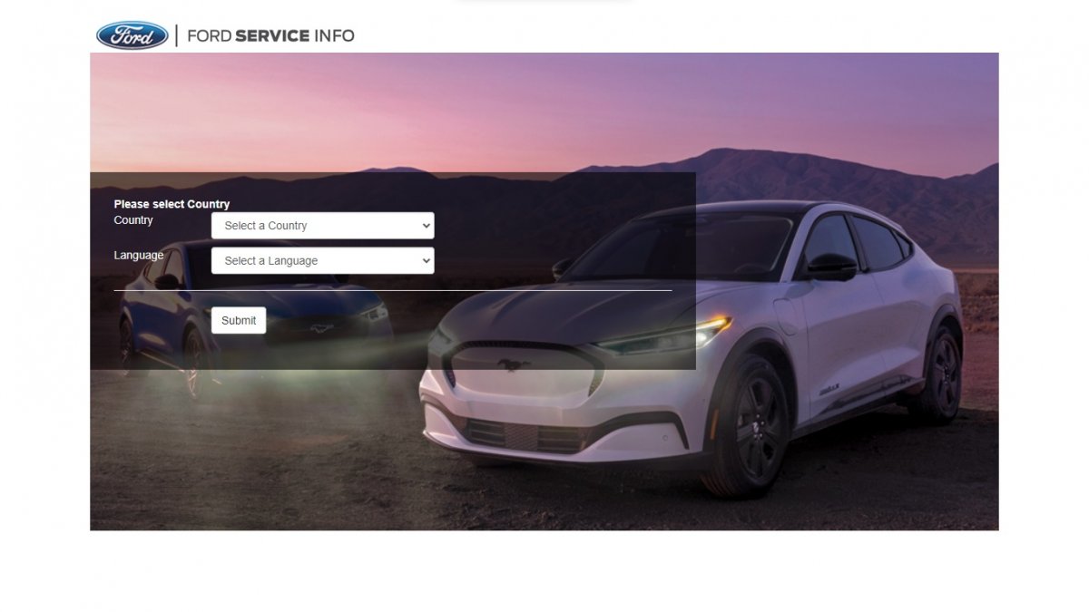

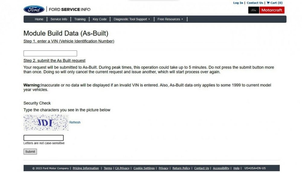

Haz Posted November 21, 2023 Report Share Posted November 21, 2023 (edited) danwdc: You're correct that the Dorman replacement Cruise Control Module (CCM) you installed needs to be programmed with the same As-Built data that was contained in the original CCM you removed. If you did not save those values from the original CCM before removing it, you can use the Ford Service Info website to review and/or save the entire set of As-Built data values for the electronic modules in your 2013 Edge Limited AWD, and then use a temporary-licensed or fully-licensed copy of Forscan to manually program the Dorman replacement CCM using the address 764-01-01 As-Built values and then save them to the installed Dorman replacement CCM. As omar302 advises, go to https://www.motorcraftservice.com/AsBuilt, and after selecting your Country/Language, submit the form... ...input your Edge's VIN and the Security Check captcha value and submit the second form... ...and the resulting As-Built Report for your Edge allows you to Download File an .AB electronic data file that includes the electronic programming for all modules, and the web page provides the same complete data set in text format for you to print for visual reference... I surveyed Cruise Control Module As-Built data for ten 2013 Edge Limited AWD vehicles offered for sale online, and I found two different programming values in use... ...so it is absolutely necessary for you to obtain CCM As -Built data by submitting your Edge's VIN to the Ford Service Info website. Forscan probably shows this Diagnostic Trouble Code (DTC) in the CCM, which you will want to clear if it remains after performing a CCM Self Test after programming the Dorman replacement CCM... U2100:00 Initial Configuration Not Complete: No Sub Type Information Document download link> Module Configuration - Diagnosis and Testing - 2013 Edge Workshop Manual.pdf Good luck! Edited November 21, 2023 by Haz 2 1 Quote Link to comment Share on other sites More sharing options...
