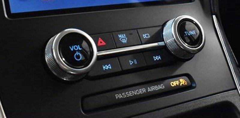

There is a single knob below the 12" screen were the volume can also be controlled (up or down) and this knob also has a symbol on it as if it's the power button but it doesn't push in. The knob is only for the volume controls.
And another knob to the right of the volume control which is just for tuning in the stations. Again just a turn dial and no push button.

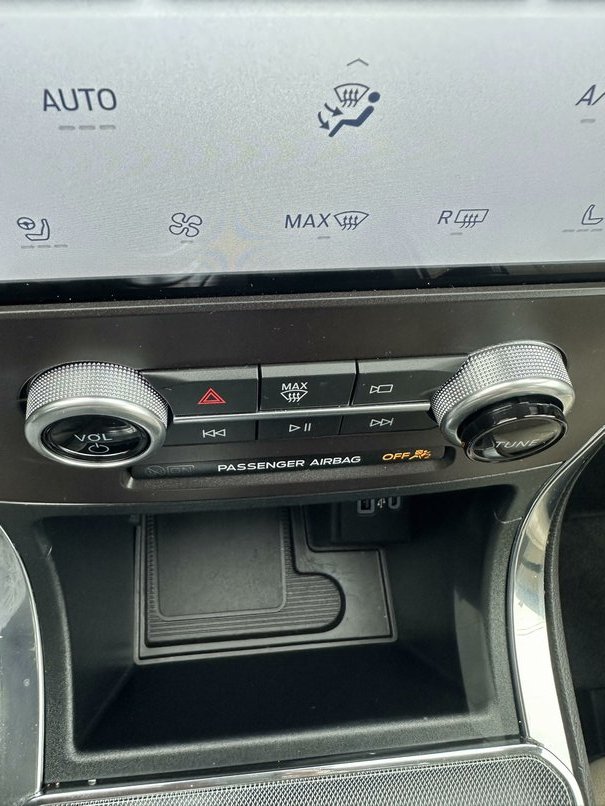

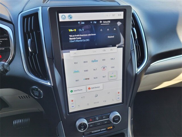

I included two photos showing the touch screen and knobs below. I believe the 2022 and 23 models are the same.
Anybody familiar with this? I can't believe Ford wouldn't have included a power off button.  ?
I can understand the power button not turning off the display since that is your only way to get to things like climate control, but if you are listening to the radio and push the volume button it doesn't turn off the radio? The owners manual shows that as how you turn off audio, I remember doing it when I was testing vehicles (I didn't want the 2023 I tried, but wanted to compare to the 2019 I wanted).

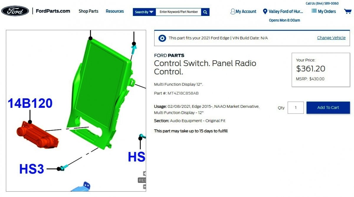

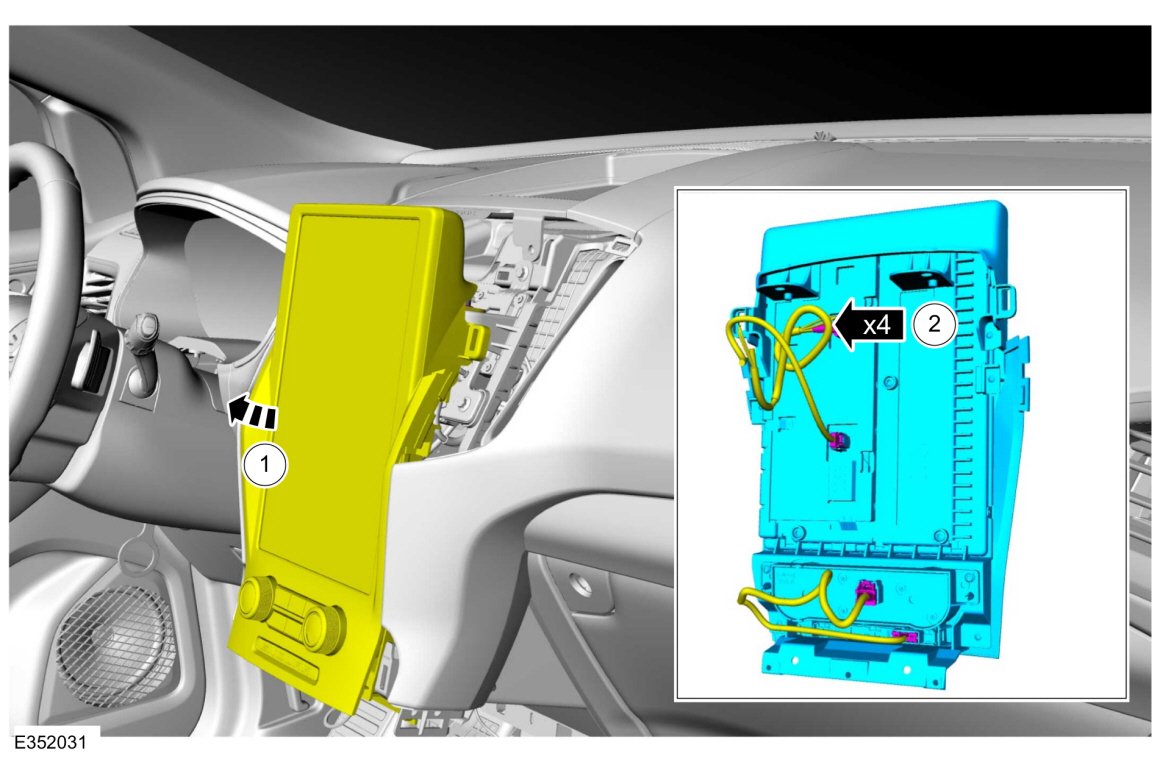

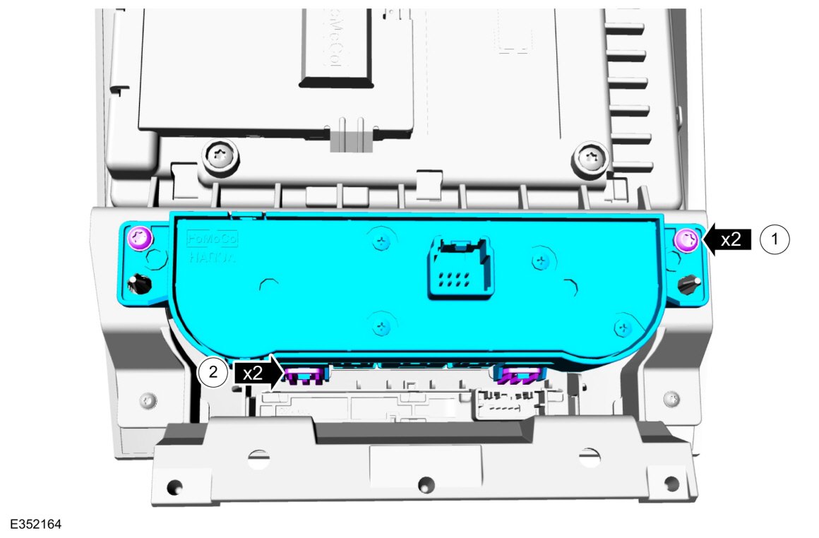

If the power switch function of the left control knob is faulty, the Radio Control Switch Panel is replaceable separate from the Display Screen...
1599044354_RadioControlSwitchPanel-FordParts_com.thumb.jpg.7ca3d68d1c4c338b33f0b84a66d4816f.jpg
550061957_12-InchDisplaywithRadioControlSwitchPanel-RemovalandInstallation-2021Edge.thumb.jpg.6db677ebd5e284490baede740d5a23b3.jpg
1156508074_RadioControlSwitchPanel-RemovalandInstallation-2021Edge.thumb.jpg.5aa5ace877aac32c810b0a5da17cccf8.jpg

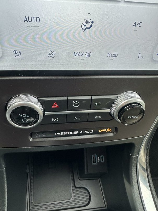

Thanks for all the helpful replies. Yes, I have tried pushing the center of the volume button, not the ring. The ring on the knob rotates which allows me to control the volume (high or low).
The center doesn't do anything. In fact, I just took a closer look and when comparing the buttons with the "tune" button, the tune button looks to be raised while the volume buttons looks depressed. Is this the problem? Has that volume button been depressed and never came back out?
Haz, thank you so much for the helpful images and links. I'm now thinking the problem is with the radio control switch panel as you pointed out.
By the way, the tune button doesn't press down. It's just raised like that. But it would make sense that the volume button should also be raised and would be pushed to power the radio on or off.
I included close up photos showing how the volume button looks depressed as compared to the tune button. Although the volume button doesn't seem to pop out. I tried.
Anybody have this year vehicle and can confirm that volume button should be raised and is also a push button? As mentioned above, this should be the same infotainment setup in the 2021, 22 and 23 models.

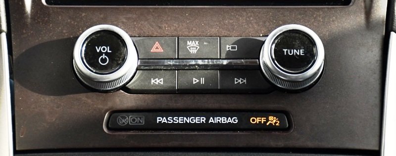

It looks like you have a 2022 which I believe is identical to the 2021 as there wasn't many changes made in these years. Does the center portion of your volume button push in and back out when pressed?
Would be nice to view a photo of what a proper placement of those buttons should look like.

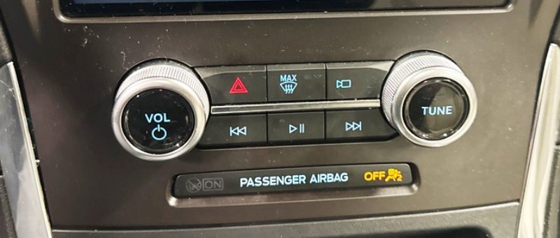

You will love your car once they fix this.  They have been de-contenting the Edge for a few years.  Although they are basically identical, 2022 misses a few things from 2021, 2023 misses a few more, etc.  (For instance, I don't have a glove box light.)  The center of the button is spring loaded and goes in and comes back out flush with the silver ring.
I didn't realize they were pulling some of the items from the newer model cars that were standard equipment on the 2021. I just went to check to make sure, I do have the glove box light.  :happyfeet:
I did so much research on these cars, mostly the 21 and 22 model and didn't notice much of any difference.
One thing that would be nice is if they could have installed a light in the center console compartment (under the arm wrest). It's so deep which is nice but gez, it's so dark in there.
I guess the factory has been working hard to to remove some of these small details that can be easily missed yet amount to lower costs for them.
Nonetheless, thanks for confirming the center volume button being spring loaded. Mine doesn't press in at all. Will be making a visit to the dealer soon. Thank you so much for the info...
I surveyed photos of 2021-2023 Edges offered for sale online and these images are representative of what I found...

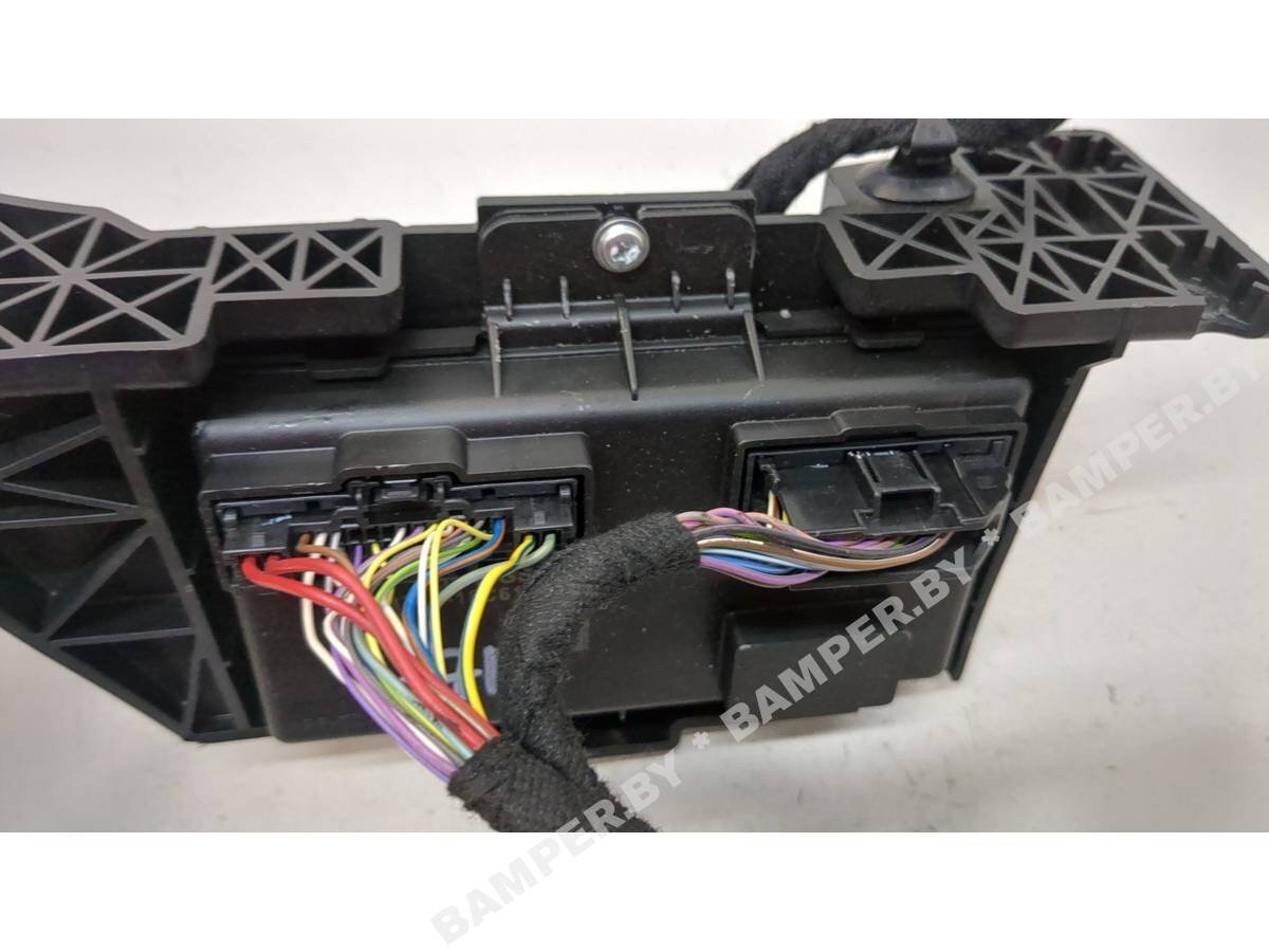

The Edge Workshop Manual offers 'Pinpoint Test J' as a diagnostic for the Audio Control Panel. Diagnostic Trouble Codes (DTCs) which are set for several faulty conditions...
The DTCs for knob control fault and/or continuous button press may indicate an issue with the Power Button.

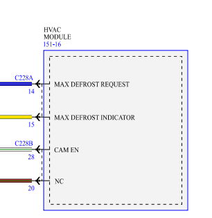

Additional Workshop Manual documents relating to the Audio Control Panel are attached for your awareness...
Document download links>
PINPOINT TEST J - THE AUDIO-SYNC SYSTEM DOES NOT OPERATE CORRECTLY FROM THE AUDIO CONTROL PANEL - 2021 Edge.pdf
Audio Control Panel to SYNC Module Wiring Diagram - 2021 Edge.pdf
AUDIO CONTROL PANEL - Connector C2009 Details - 2021 Edge.pdf
AUDIO CONTROL PANEL - Connector C2009 Location - 2021 Edge.pdf
SYNC MODULE (APIM) - Connector C2383A Details - 2021 Edge.pdf
SYNC MODULE (APIM) - Connector C2383A Location - 2021 Edge.pdf
Audio Control Panel to Body Control Module (BCM) Wiring Diagram - 2021 Edge.pdf
Audio Control Panel to Ground Wiring Diagram - 2021 Edge.pdf
Audio Control Panel to HVAC Module Wiring Diagram - 2021 Edge.pdf
Audio Control Panel to Body Control Module (BCM) Hazard Lamps Wiring Diagram - 2021 Edge.pdf
