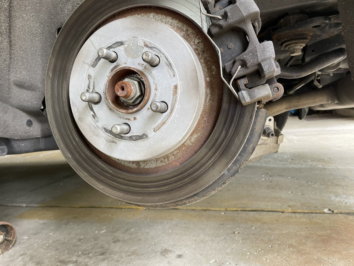

johnmarkp Posted May 21 Author Report Share Posted May 21 Update. From a performance standpoint I am very happy with the Powerstop rotors and pads. I am not sure what to think about the amount of rust I am seeing on their "Fully Coated" rotors. I sent them an email with this picture. It will be interesting to see what they say. I think this is an unacceptable amount of rust on rotors that I installed 9 months ago. I would like to hear what others think? 1 Quote Link to comment Share on other sites More sharing options...

1004ron Posted May 21 Report Share Posted May 21 I have never found a factory coated rotor that doesn't look like that in a relatively short time and that's why I paint mine. POR-15 High Temperature Brake Caliper Paint, Heat Resistant Coating, 8 Fluid Ounces, Silver 1 Quote Link to comment Share on other sites More sharing options...

johnmarkp Posted May 22 Author Report Share Posted May 22 Powerstop got back to me and blew me off. Basically, all rotors rust, so whats the problem. This is what they say about the coating on their site. "Evolution coating for maximum protection against rust & corrosion" They do not make any disclaimer about rust. No asterisk! So their coating is a complete waste of money. Lesson learned. 2 Quote Link to comment Share on other sites More sharing options...
Samurai Edge Posted May 23 Report Share Posted May 23 I have never seen coated rotors stay coated for very long. Give it about a year of use up here in the NE and there is virtually no coating but mine have never seen as much rust as yours are showing in your picture. Your rotor looks like it has seen some heavy wear. I see what looks like multiple score lines and chatter marks. I have also seen several people above mention shudder or shimmy when applying brakes. That is typically from rotor dust baked onto the rotors from overly light braking. Easily removed by application of several 60 - 10 MPH panic stops. This will burn off the deposits. Just be careful wherever you do this so you don't cause an accident. Empty roads later at night are usually best. 1 Quote Link to comment Share on other sites More sharing options...
