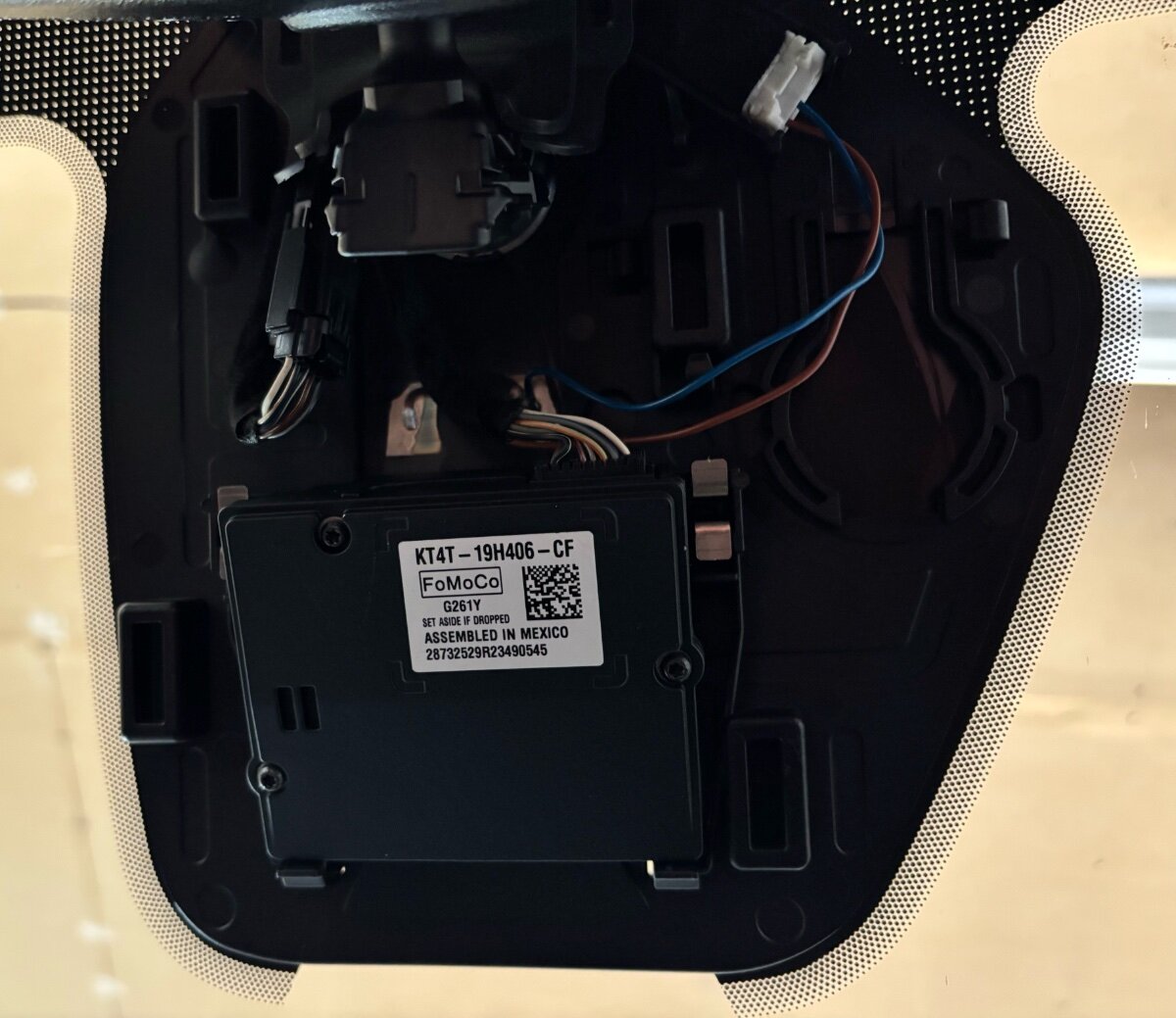

HiQ Posted 9 hours ago Author Report Share Posted 9 hours ago Not the easiest thing to get a decent picture of, but what am I looking for? There's the spot for the co-pilot sensors I assume. Should there be more? Quote Link to comment Share on other sites More sharing options...
1004ron Posted 1 hour ago Report Share Posted 1 hour ago Definitely need a replacement windshield to mount the rain sensor. See the rain sensor mounting in the below thread: Quote Link to comment Share on other sites More sharing options...
