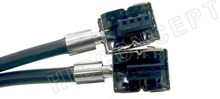

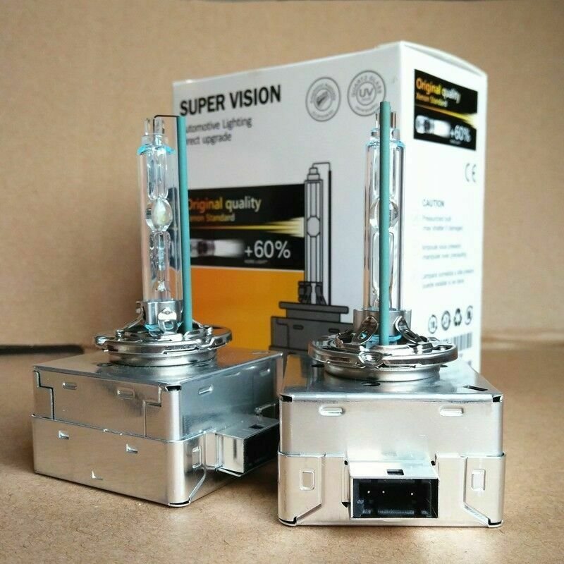

yeah those are halogen fittings. HID was optional tho on the Sport, as part of the Equipment Group 401A – Technology Package https://drive.google.com/file/d/1_3Rmp0PrPfGFN898FZZuGBiob8UuZvOr/view?usp=sharing This is a typical D3S connection https://www.hidconcept.com/products/mitsubishi-d3s-d3r-connector-pack-of-2
