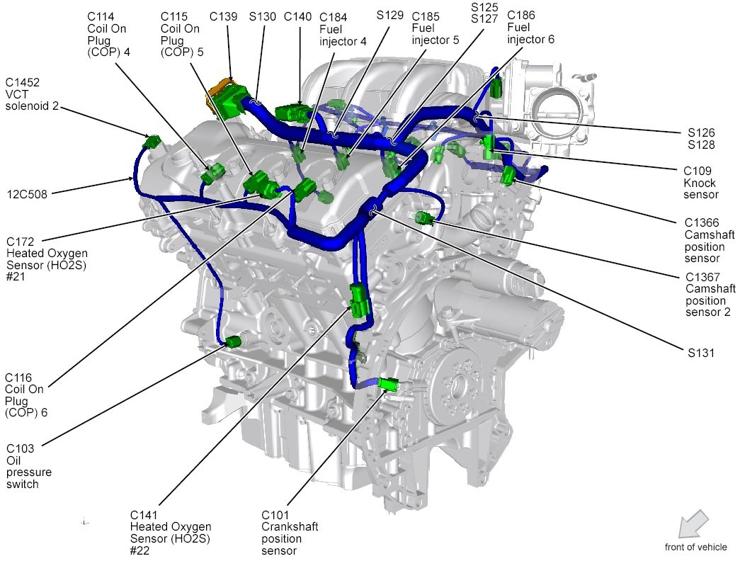

Looking for step by step to remove oil pressure sending unit.
WWWPerfA_ZN0W replied to Nate Shamblin's topic in 3.5L
this should help somewhat. it is a tight space, but doable without removing anything major. https://www.youtube.com/watch?v=sM8W0qzwhGU -

Edge turns over several times, doesn’t start,,,
WWWPerfA_ZN0W replied to kapk22's topic in Accessories & Modifications
too bad the gen 1's don't have an FP PID like the 2011+ do. would make checking fuel pressure SO easy. but i would definitely advocated doing this check before going to the heartache of replacing the CKP sensor. -
2010 Ford Edge Fuel System Pressure Test.pdf -
Left and Right are references to a longtiudinal engine as viewed from the driver seat. so bank 2 would be left, bank 1 would be right hand. Crankshaft Position (CKP) Sensor Item Part Number Description 1 W701542 Heat shield nut 2 W701669 Heat shield bolt 3 6K342 Heat shield 4 6C070 Rubber grommet cover 5 14A464 Crankshaft Position (CKP) sensor electrical connector 6 6D327 CKP sensor bolt 7 6C315 CKP sensor Removal and Installation With the vehicle in NEUTRAL, position it on a hoist. For additional information, refer to Section 100-02 . Remove the LH catalytic converter. For additional information, refer to Section 309-00 . Remove the bolt, nut and the heat shield. To install, tighten to 10 Nm (89 lb-in). Remove the rubber grommet cover. Disconnect the Crankshaft Position (CKP) sensor electrical connector. Remove the bolt and the CKP sensor. To install, tighten to 10 Nm (89 lb-in). To install, reverse the removal procedure. -
