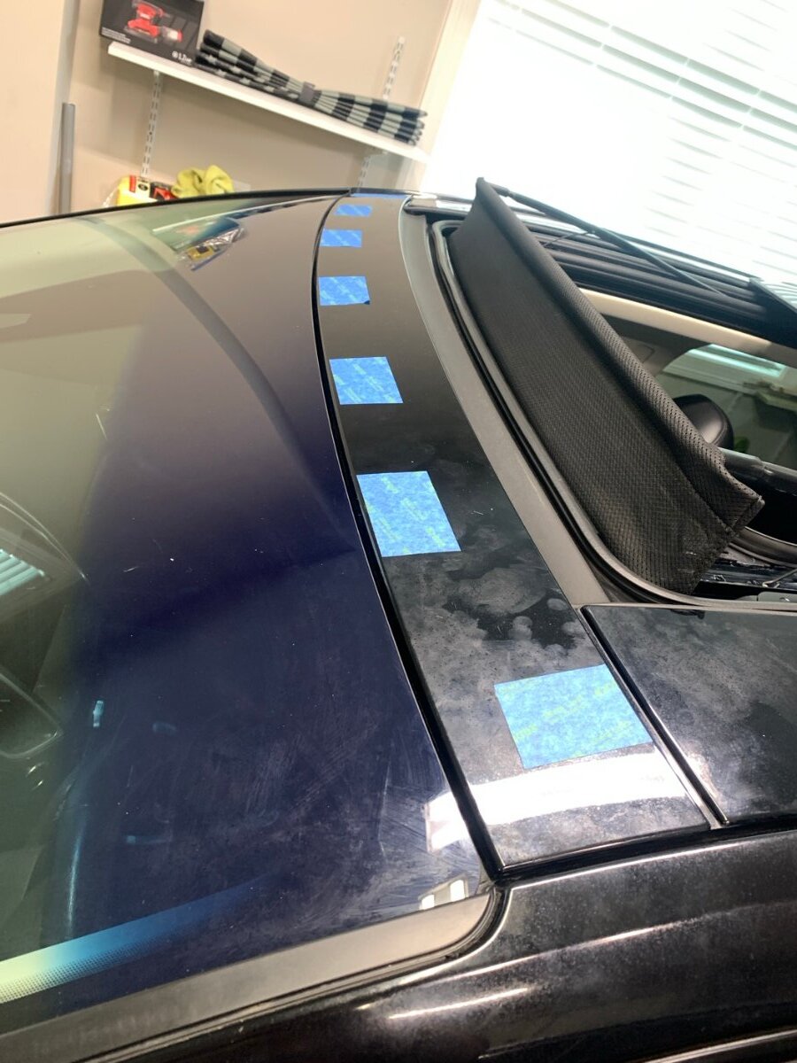

Job done. After a closer look I could tell that this was a botched installation by SafeLite when they installed the 3rd windshield. I placed painters tape over the areas above the 7 white plastic clips and started at the far left thumping the tape and hearing the clips engage. I'm confident that its secure now. -

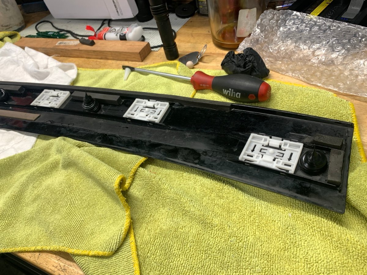

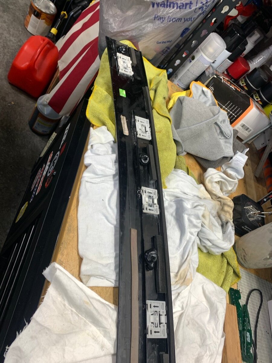

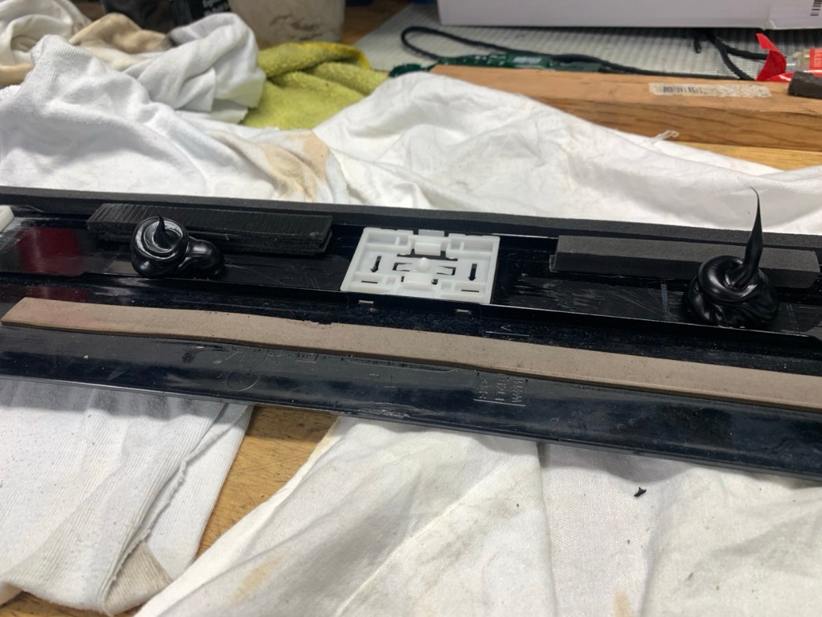

Windshield Replacement
1004ron replied to 1004ron's topic in Glass, Lenses, Lighting, Mirrors, Sunroof (BAMR), Wipers
@Haz I put your instructions on the trim piece at the top of the windshield to good use today. I went through the car wash and the high pressure jets directed at the roof caused a major noise so I knew something has come adrift - pull over and the trim piece was holding on by just the far right side. I re-attached the far left white clip and drove home. At home I started removing it and found that it was only one spot of SikaFlex holding it from coming off. All the other spots of SikaFlex were not high enough to make contact with the trim piece and the body. I should received the tube of SikaFlex on Saturday and will check with my local Ford dealership if they have the white clips in stock, or it will be a wait for that. Not bike weather so I forced to use the car without that trim piece. This was obviously a bad installation from the assembly and the SafeLite just disturbed it during the install of the third windshield. -
